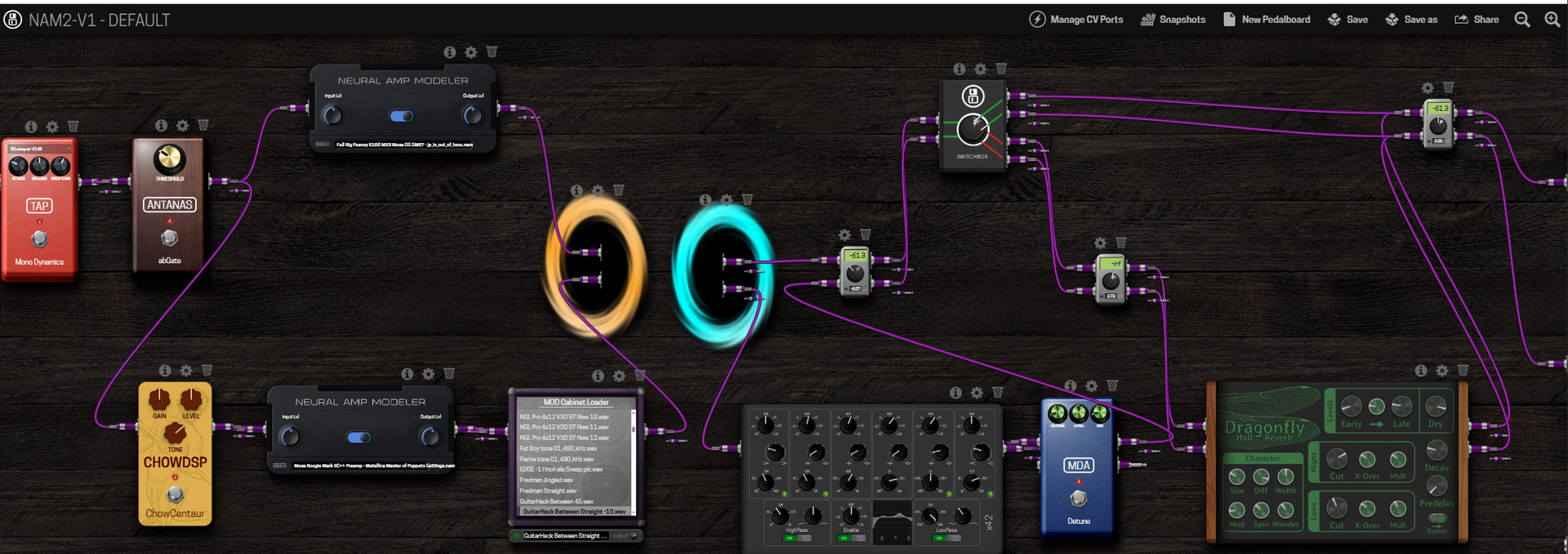

My first experiments with the new NAM A2:
This is awesome.
2 NAM’s for a greasy stereo blend, an IR cab, a Dragonly, an EQ and some pedals and while playing I’ll go to about 77%!
