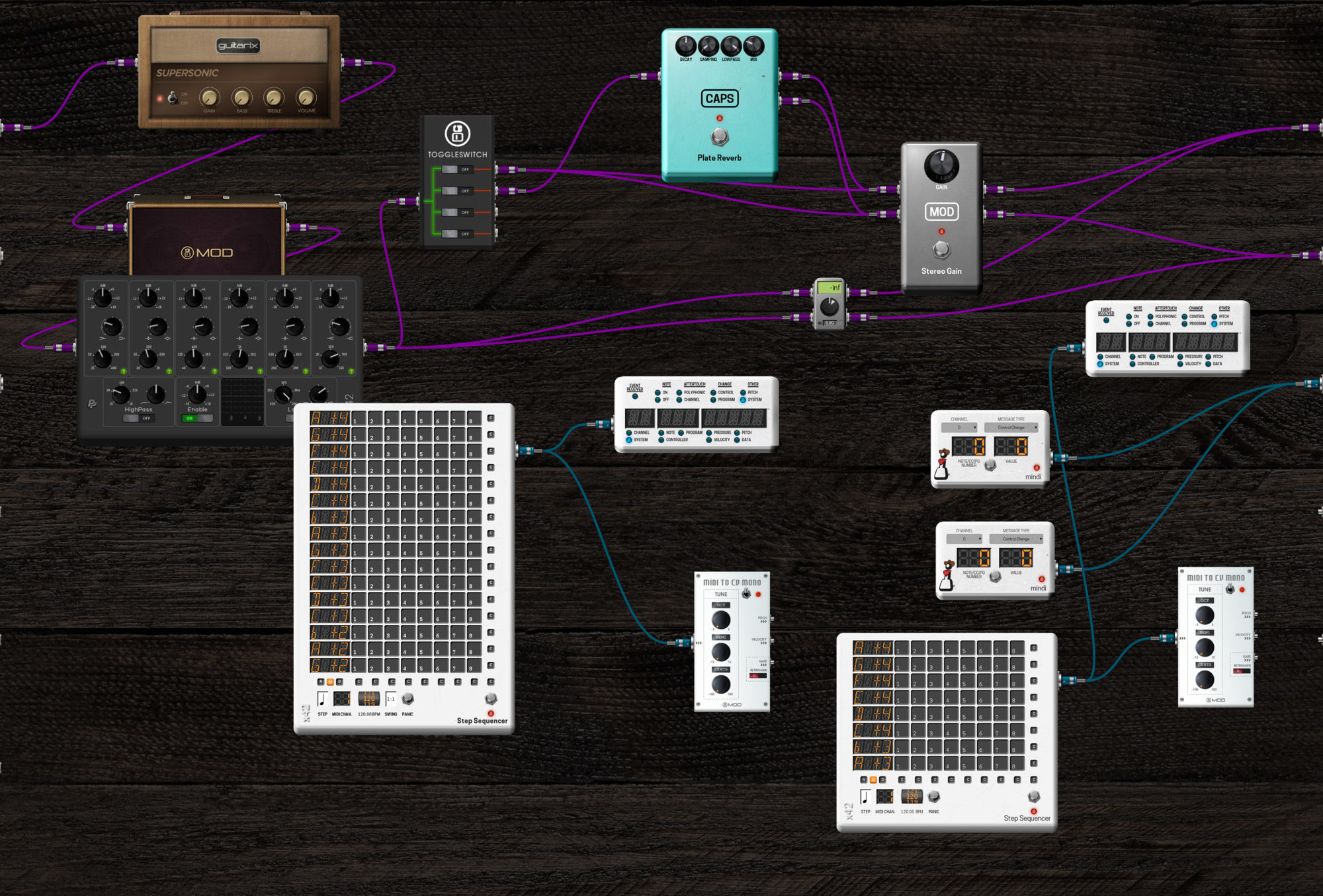

I am trying to do some presets with different intervals but it is really pain in the ass, since whammy does not read PC messages properly. If you check what notes (and then PC messages are sent) by sequencer they do not match midi implemention chart of whammy. I managed to make a preset with oct up and down with drop, but I feel that the notes that are played by seq are read randomly.
check the big seq - midi display shows different values than are set by seq - why?
even when big seq is turned off it still send commands, how is it possible?

On my test boards the CV out was about +3 on the values so turned the pitch knob down and that helped but skipped a random PC change. I had 43-50 mapped and it initially went 46-53 then when I dragged the pitch down it was 43 - 51 as it missed 46 out. Odd behaviour definitely.

āOn my test boards the CV out was about +3 on the values so turned the pitch knob down and that helped but skipped a random PC change. I had 43-50 mapped and it initially went 46-53 then when I dragged the pitch down it was 43 - 51 as it missed 46 out. Odd behaviour definitely.ā - I had this same, and no 46⦠Strange thing is that if you try to send low notes to get PC1 - 10 difference between sent note and PC is +1, not +3 as when I tried to get PC 43-50. I 've noticed that some notes do not match to whammy midi impementation, lets say I 've sent 45 and completely different interval has been turned on than it supposed to be.

Arenāt you using the same CV port for both sequencers?
good to know it is a problem of whammy not my lack of cpu, it was really frustrating.
I must check it, but the idea was to use separate cv port. I ve made a preset on a big seq and on a small one, they work quite nice. The preset on big seq is made on the whammy section, a preset on the small seq is made using drop section.

I checked all values sent by seq from 0 to 127 and then converted into CV and then controlled PC number of mindi. So, the problem is that when seq reach value 9 cv adds 1, that is why it is not possible to get dive bomb, because value 9 sent by seq is read as 10, so there is 1,2,3,4,5,6,7,8 and 10. Next switch is when we reach value 26 - midi to CV adds 2, so it is not possible to get PC27 (5th off), another switch is at DROP 4th ON - seq value is 43 plus 3 (not plus 2) so it is not possible to get 4th interval, last switch is at DROP 4th Off - seq sends 60, mindi read 64 (not 63). So Midi to CV four times adds one number to recived value.
To sum up - Midi to CV pluggin adds extra values to received MIDI CC or Note.
