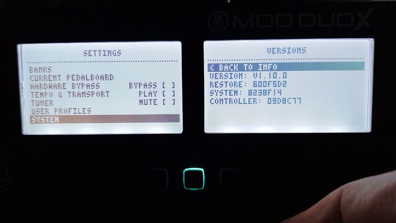

With the update to release 1.10, my displays are flickering. Strangely enough, only when the encoders are moved in the first third.

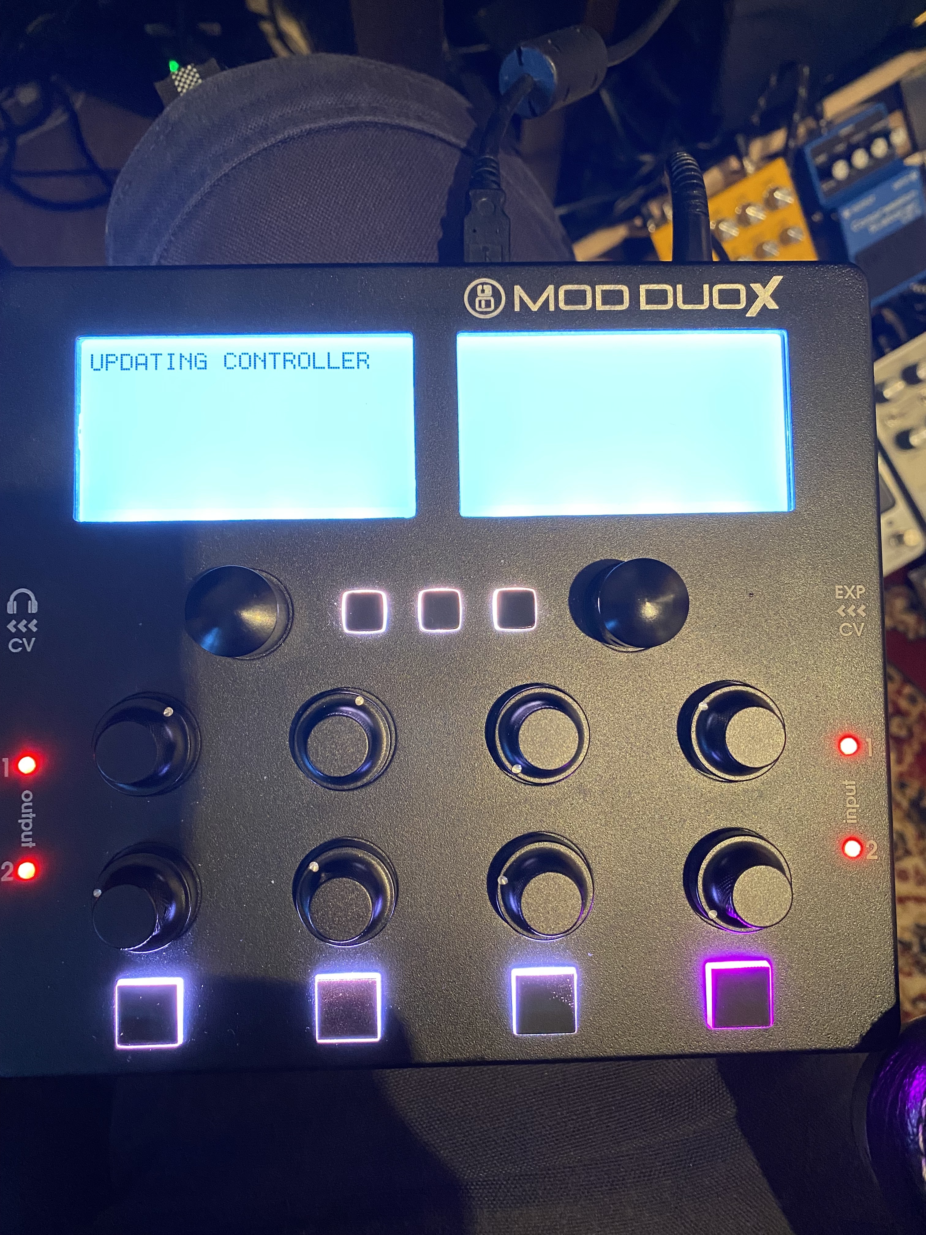

The screen goes bright when its says updating controller and everything looks as if first did when i bought it but once the update is complete the screen only looks about 50% bright even on 100% and it flickers and the values are unstable again?

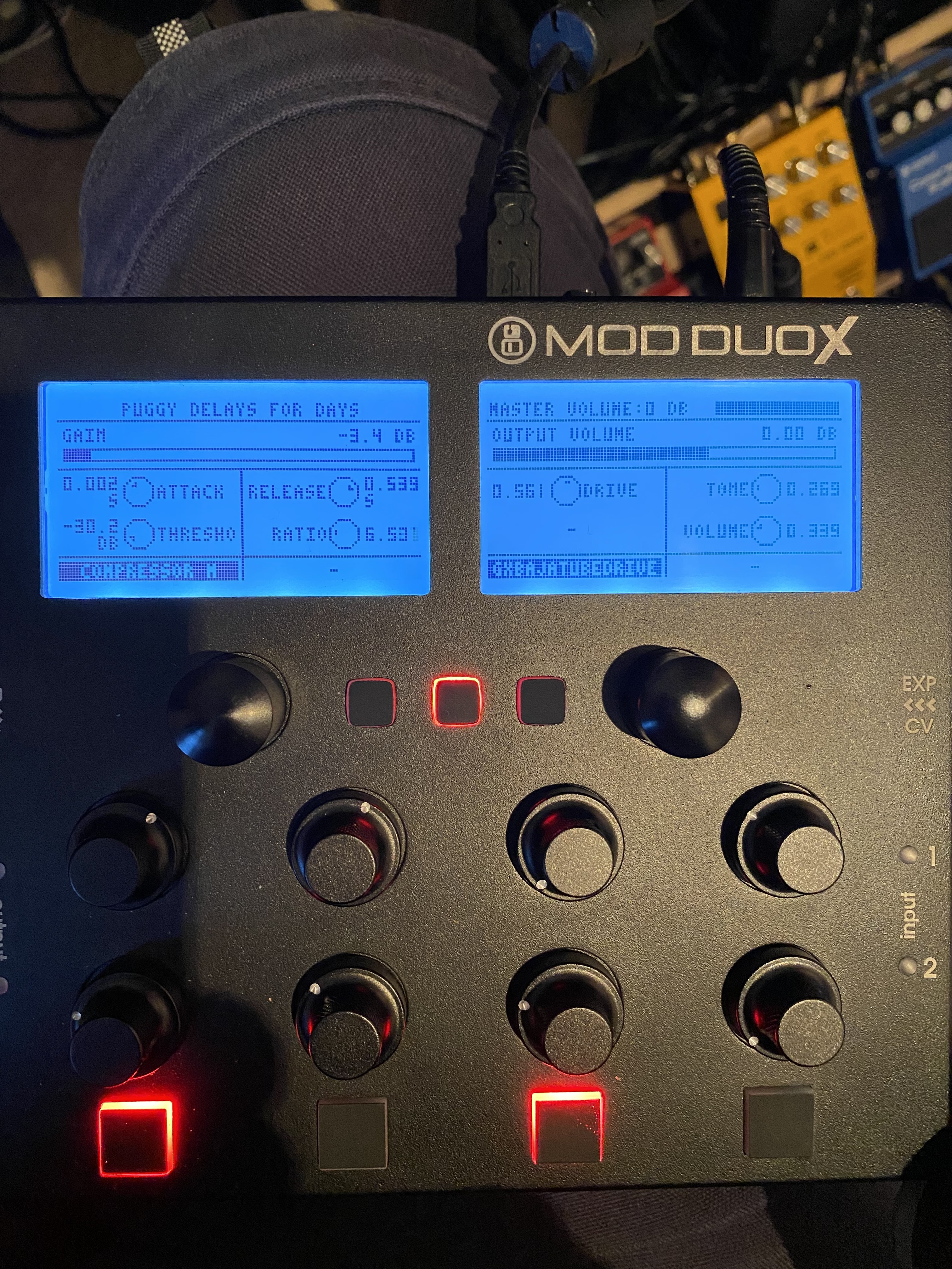

So sad, my unit started having this flicker issue after a recent update. I’ve tried different power supplies, even ordered the one that was listed in the wiki and I am still having the issue.
I’m currently using the latest version and 1.11.4.2784.
Help, it’s really annoying.
The key thing I noticed is that the default brightness is lower than it was before. When it flickers, the flickering is at the higher brightness.
The brightness difference between 75% and 100% is almost none. So the display is now dimmer than it used to be. Any advice? Help?

Thanks Jon, I’ve emailed support. I created a video with the issue. It’s the same issue Sorkycat describes. When the device is updating it goes to full brightness (giving you hope), then once the update completes it goes dim and the flicker is just horrendous.
I have a video of the update process and the flicker for reference. I added this and my serial number to my support request. Hope we can nail this bug, love my duo X.
