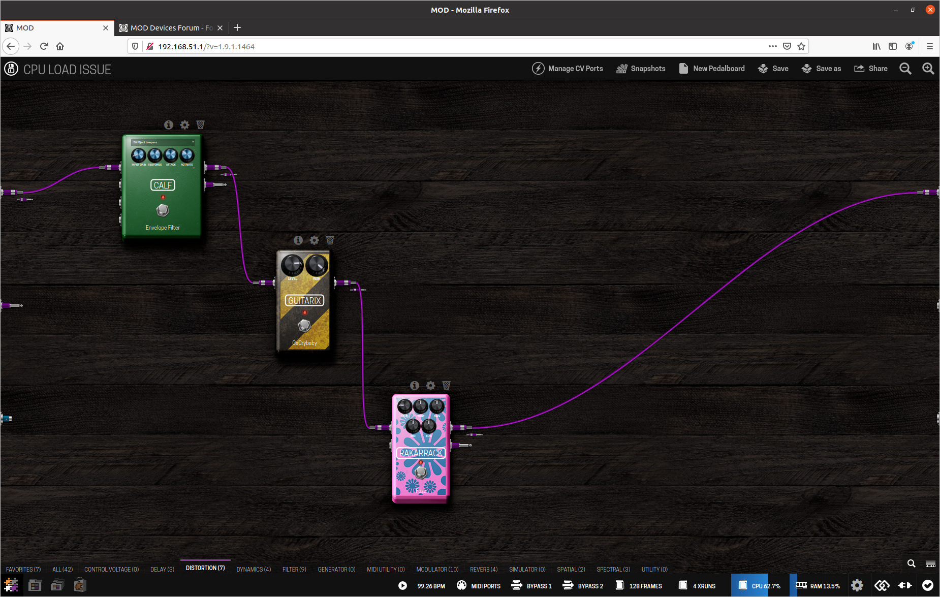

One of my pedalboards has got a very high CPU load and I started to optimize it.
During optimization I found out that the CPU load of the MOD Duo also seems to depend on the audio routing.
Then I started to dig a bit deeper, and began to strip down the original pedalboard in order to find the source of the load.
In the end I found two easy to follow combinations that seem to contain the problem that I just don’t understand - maybe it’s a bug in one of the effects??!
The following two pictures show the same pedalboard - just with different routing.
The pedalboard contains:
  • Calf Envelope Filter v60.0-9
  • GxCryBabyGCB95 V28.3-23
  • Rakarrack Fuzz v0.0-6
All three effects are activated.
In this routing setup the CPU load is around 37%:
But in this routing setup the CPU load is around 60%:
Why does it make a difference for the plugins where signals come from / go to??
Thanks in advance for your thoughts and help.
This is simple. The audio graph runs in multiple CPU cores when possible, which happens to be the case for pedalboard 1, but not pedalboard 2.
On the 1st pedalboard, the 3 effects can run at the same time, then the output only has to wait for the “worst” plugin to finish.
On the 2nd pedalboard, each plugin has to finish processing before the next one can start.
