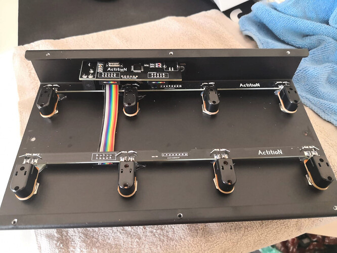

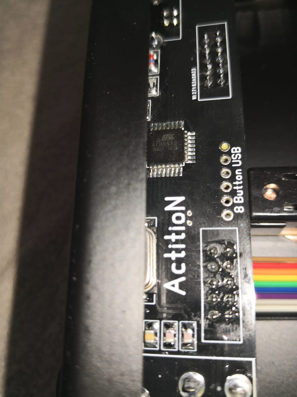

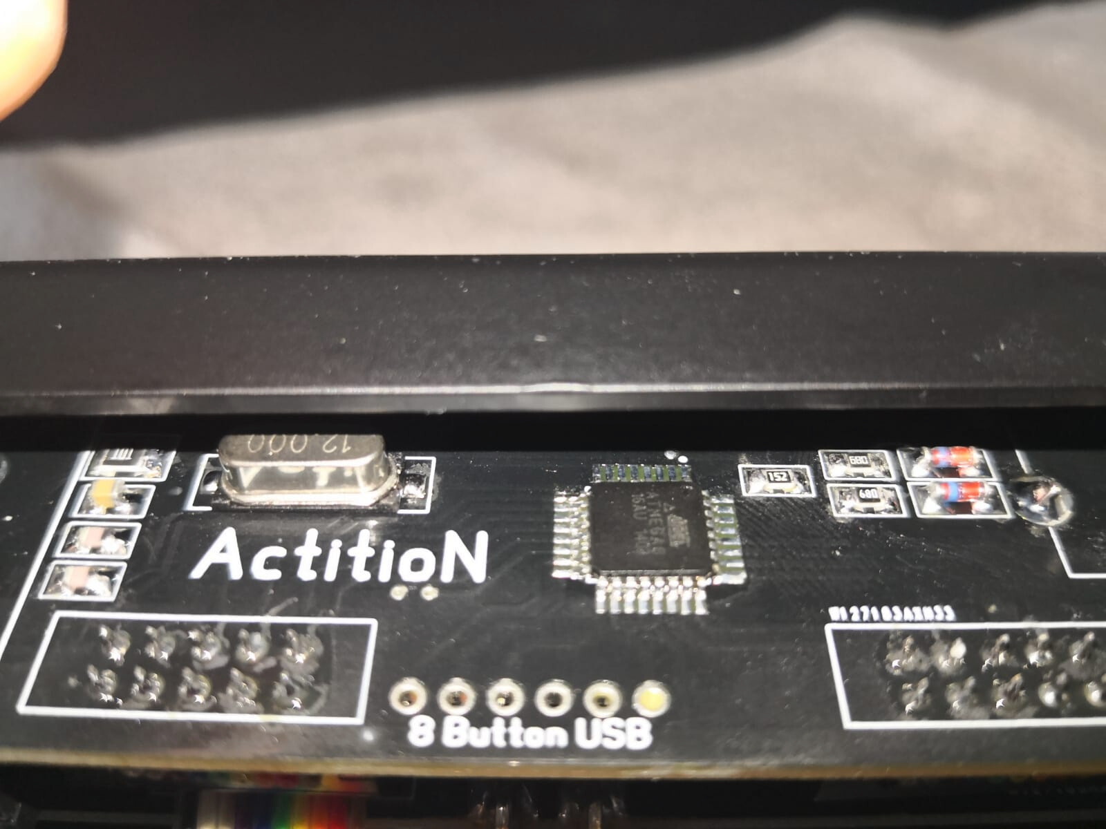

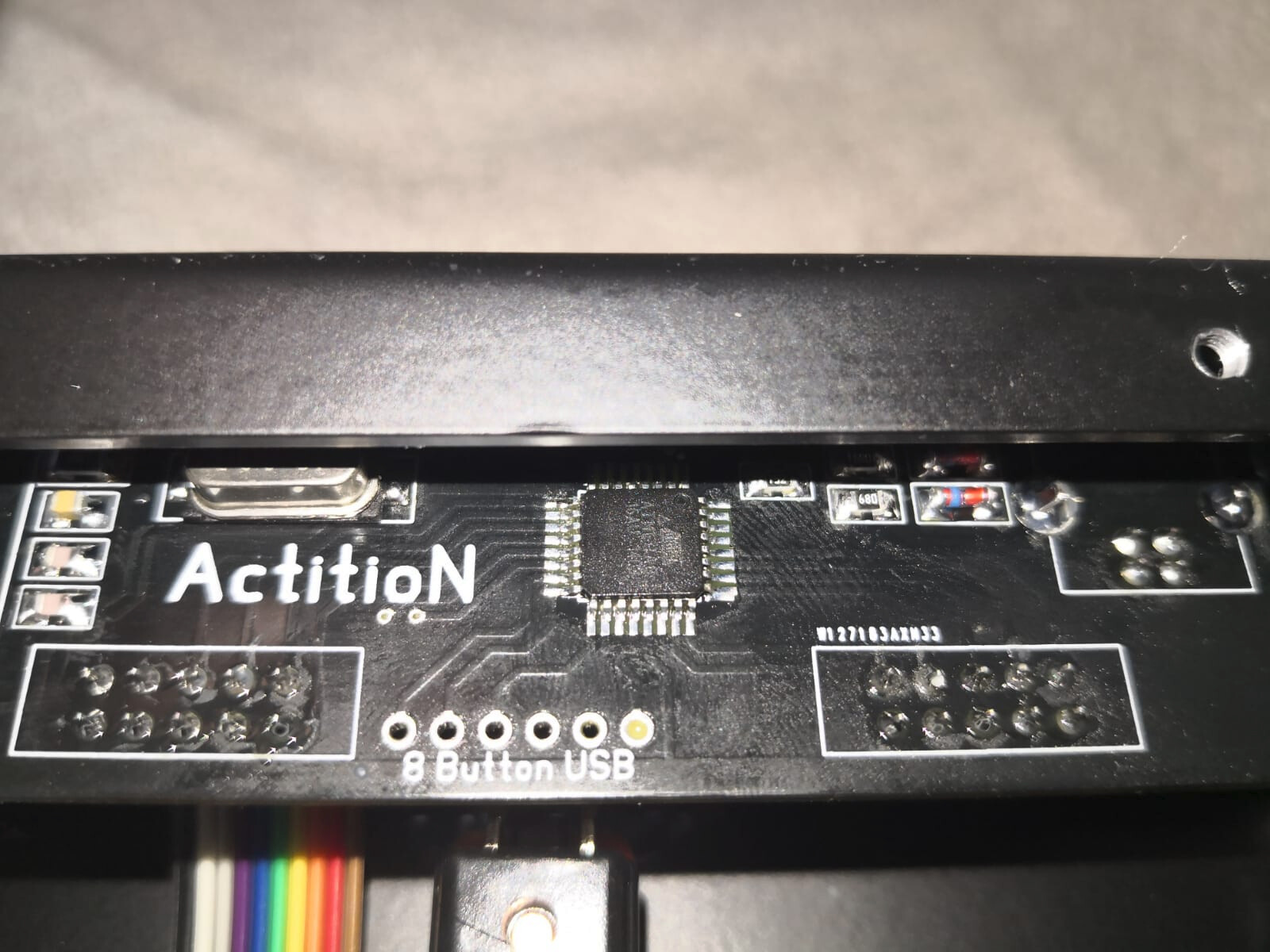

Vendor is ActitioN so I didn’t resist…
The chip model should be ATMEGA6 or ATMEGA8
ATMEGA8-16AU 1403
looks really nice and clean. Its probably a barbones arduino (chip is the same) with a custom bootloader and without the usb interface (needed for easy programming with arduino ide)
Again your best bet would be to replace the board with an arduino and the USB HostBoard
