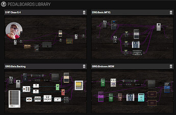

Just trying stuff for fun…
I can now easily identify my own pedalboard on the pedalboard library! :stuck_out_tongue_winking_eye:
