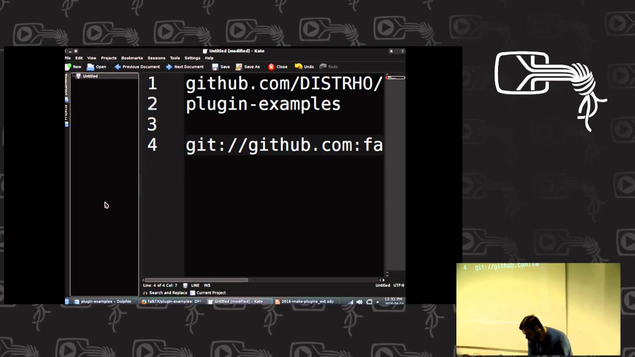

There was a long FalkTX video introducing DPF -
Quite valuable bonus for DPF is that it’s developer is a part of the MOD team, and has a presence on this forum.
