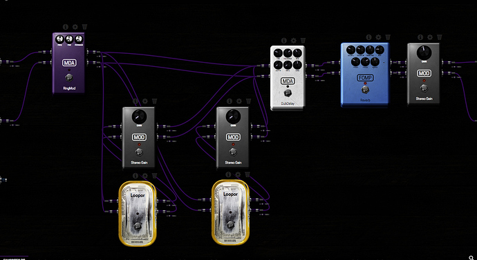

I have two separate loopors up and running,
each running into a “MOD stereo gain” so I can mix them independantly “into” the dry signal.
There’s a bit of noise from the gain, and there’s a slight leak when turned completely down
.. gain set to -40 to 0.
But definitely a huge step forward! I can use this setup :+1::sunglasses:
.. will make a 3-loopor system tomorrow, excited to see how that will work!
