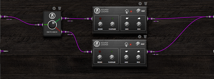

I consider the looping part itself covered by SooperLooper already. What’s actually missing are the following changes / devices to make it possible to build your own multi-channel (optionally stereo) looper:
I was actually surprised when I found out these two features weren’t available when I was trying to build - you guessed it - a multi-channel looper.
Would you mind explaining that in different words again, @fzero ? I am not sure what you mean by “switching to different outputs.” You want to record the same loop simultaneously on several loopers?
No, I want to have several loopers running in sync - which would be very easy to achieve if we could assign one switch to start recording/playing on all loopers - and pick which one I want to record to. If we had this feature, something like this would do the job (simple mono example):
With a stereo Switchbox device it would be possible to have 2x2 channels, so a dual stereo looper. The key here is still the ability to trigger recording on multiple devices with a single switch. This way, even though one of the loopers (or stereo looper groups) would record silence until the Switchbox changed, all loopers would be locked to the same loop length. Once the Switchbox changes, the other looper would receive audio and everything would stay in sync.

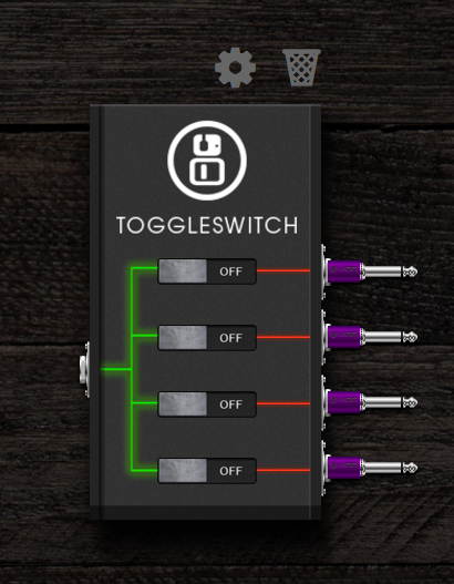

To make this better we’d need a one-to-n Switchbox device. ToggleSwitch4 looked promising, but it requires a distinct switch for each of the outputs instead one switch to toggle between all outputs.
This is completely useless for our purposes.
