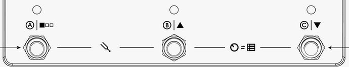

I’ve an alternative:
We have three footswitches.
Currently, on the Control Mode, they works like:
  • (A) changes the current page of the control mode;
  • (B) changes the current state of an effect¹;
  • (C) changes the current state of an effect;
  • (A) + (B): go to turner
  • (B) + (C): switches between control and navigation mode

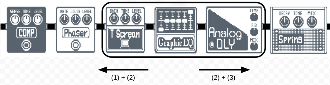

I purpose an “expanded mode” by applying the following changes:
  • (A) changes the current page of an effect (like (B) and (C));
  • (A) + (B) short press: go to the previous page
  • (A) + (B) long press: go to turner
  • (B) + (C) short press: go to the next page
  • (B) + (C) long press: switches between control/navigation mode
I think that we didn’t get some conflict here, because apparently isn’t possible to long press both neighbor footswitches at the same time, right? Because of the action precedence, right?
The biggest problem apparently is a possible relabeling of the (A)
image. A “gambiarra” (workaround) for this situation is add an option in the configuration to enable/disable the “expanded mode”, then, the icon in (A) will continue to make sense :sweat_smile:

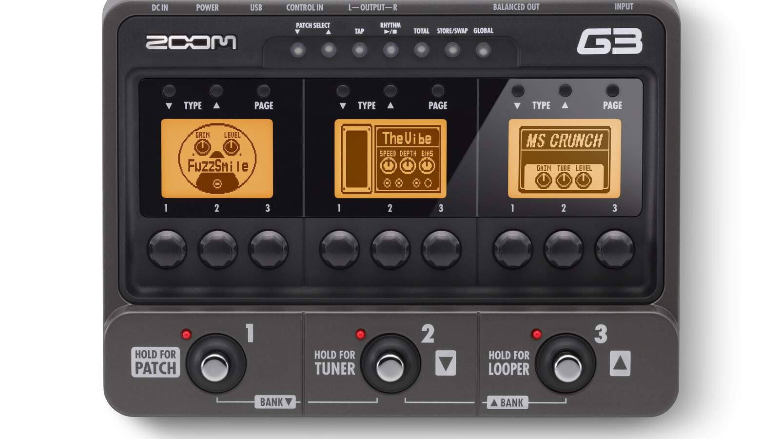

My inspiration was by Zoom G3:
On its initial version, in a patch (its equivalent pedalboard) there was only possible to put three effects. Each effect can be switched between on/off state with their correspondent footswitch.
After some months, the Zoom company launched a update where now is possible to load six effects in a patch. And instead press the 1+2 footswitches and 2+3 footswitches to change the current pedalboard, its now scrolls between the effects view
Fun fact: Zoom didn’t “relabel” the new Zoom G3 equipment after this change.

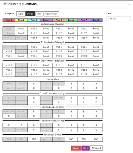

Could it be simple like this ?
on the 1st page
  • switch B
    – turns ON Delay on simple tap
    – turns ON Reverb on longpress
    (so momentary and Groups are unavailable)
  • switch C
    – is Tap tempo
    (so momentary, double tap and Groups are unavailable – longpress is still available)
on page 2
  • switch B
    – turns ON Tremolo on simple tap
    – turns ON panner on longpress
    (so momentary and Groups are unavailable – double tap is still available)
  • switch C
    – turns ON crunch on simple tap
    – turns ON distortion on longpress
    – turns ON bit crucher on double tap
on page 4
  • switch B & C are use for snapshots
    (so everything else is unavailable)
on page 5
  • switch B
    – turns ON resverse on momentary
    (so normal, longpress and Groups are unavailable – double tap is still available)
There would be a few problems i can see with this
  1. You can’t have footswitch groups on the Dwarf because there are already hardware functions that are linked to pressing A+B or B+C
  2. Momentary could not be assigned on a footswitch on top of the other types of presses (toggle, hold, double press) because the interactions would conflict with each other
  3. If you take away footswitch groups and momentary from the image you mocked up, it could be a good layout for mapping but it would be more confusing for new users which is something we are trying to reduce
  4. If you have 2 or more types of assignments on one footswitch, you can only have a label for one, so either the user or the hmi would have to de ide which label to display. This would be pretty confusing in my opinion. If you had a multifunction button plugin then the label would just tell you its the multifunction button
Mmm… Then I think you could ask directly the ModTeam to remove that function, but I think it is a really bad idea because it works pretty well and is quite useful.
Exactly ! That’s why I proposed to make momentary unavailable when another function is chosen. And vice-versa.
I thought that only double-tap could work at the same time as momentary, but now I’m not sure it is a good idea…
The way the grouping function works currently seams perfect :
When you chose an assignment to footswitch B - > grouping B&C is unavailable.
Those functions could be activated in the main parameters, a simple checkbox unchecked by deault : activate double-tap and long-press assignment to footswitches. So the new users wouldn’t see those assignments.
The Morningstar midi controllers make it possible be default, didn’t thought it would disorientate to much MOD-users, but I trust you on this one.
