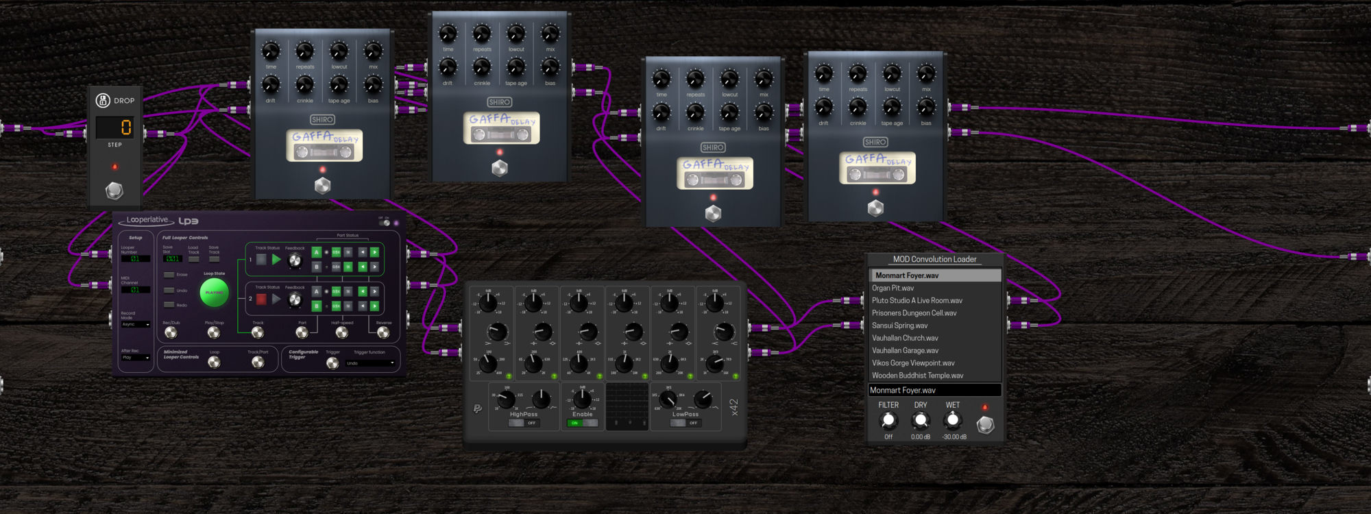

Day 2 with Dwarf. I just recorded a small songidea with LP3 and had my guitar running through Compressor, EQs, Drop, & IR loader. I am very happy with that and I’m a bit surprised, that I am really happy with the audio input quality of Dwarf. It is just what I expect from such a device.
I ran into problems with the CPU load (of course) & what really annoys me is, that CPU Meter jumps around and sometimes Dwarf has dropouts. After enabling that experimental Jack Manager it stopped jumping and was very reliable. But it again changed shortly after… In most cases I would prefer that to dynamic CPU distribution causing dropouts in certain situations.
What are the settings, that make Dwarf most reliable on 128 frames buffer? For me it makes ratrher problems, when CPU goes down while not playing guitar. That jumping CPU meter seems to cause glitches :frowning:

@falkTX Gaffa shiro seems to be jumping :frowning:
@falkTX Hmmm, are all/many delays jumping? Dub3 also… but less often…
Sooo difficult. Maybe it is the combination of Convolution loader with others. Without convolution loader this doesn’t jump.
I use Gaffa and haven’t experienced this. However, I’m not currently using any of the convolution reverbs. I’m using Shiroverb MK II, Triple Chorus, Gaffa, Stereo Echo, and LP3. My CPU ranges from 38%-41%.
You’re right. It seems to be combinations. In the above test 4x Gaffa do not jump… But with convolution loaeder…

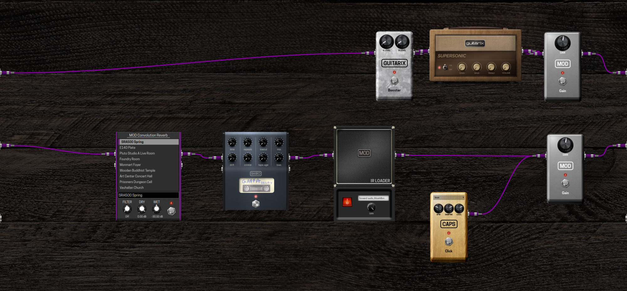

I’ll throw in my own experience here. I’ve got 2 IR Loaders + a single instance of Gaffa and I don’t see CPU jumps. It fluctuates between 60-62% for this pedalboard.
@malfunction54 Could you share it? I would like to test it with my dwarf…
unfortunately, the amp sim was built locally on my system. I can put in another amp sim and publish that one.
Update: Here’s the modified pedalboard
@malfunction54 I can easily get random CPU jumpes 20% from 69% up to 90% when enabling Gaffa, cabeling stereo and adding a LP3 to your project :-(. Yes, the project as you send it is stable.
@malfunction54 I set the latency to 256 and was able to run 6 convolution devices along with the other ingredients of your poject. With the 6th convolution device CPU arbitrarily jumps up to 15%. while with 5 it seemed stable…
A few things here:
  • enabling/bypassing a plugin shouldn’t affect CPU (well, really DSP) usage. Once you’ve added it to your pedalboard, it’s using DSP time. Connecting the plugins also may increase CPU usage.
  • I added LP3 to my pedalboard and saw periodic spikes in CPU usage, eventually causing xruns, but not much
  • I loaded your original pedalboard and saw the behavior you described in the original post
  • I removed the LP3 from your pedalboard and the CPU usage stabilized around 62%
  • I added a total of 4 Gaffas to my board and connecting them raised my CPU to 100% (probably more)
  • backing down to 2 Gaffas on my board put the CPU at 67%, but it fluctuates regularly to 100%
I think you just need to pare down the plugins, or find plugins that consume less CPU. Or, run at 256 frames if you can tolerate the latency. But, YMMV and this is just one person’s observation.

@looperlative Yes, like malfunction54 described. I optimised where possible (x42 convoluton device reduced load and I tested all reverbs and echoes and found a compromise to have both on board, I turned off all unnecessary processing like Noisegate & Compressor & sync…), and it seems that LP3 EDIT: LP3 & Gaffa in combination really spike the DSP.
I have 3 LP3s in that project (but that makes no diffrence to 1) and without spikes/LP3 it would settle at below 70%, but with the spikes I get xruns and crackles. It’s only once in 30sec/1minute, but it kills some fun. It’s allways the same: I’m sooo close to having that workspace perfect and some weired problem makes it hard to use it fearless or smooth. It’s really so close & I tried 256 latency and it is not so much fun, because of that noticable delay. To my surprise I’m quite satisfied with 128 latency… ah, and the spikes are also there with 256, but the higher buffer handles them with less problems.

ok, maybe I reduced the spikes heavily by deactivating Gaffa, I didn’t delete it, just turned it off. Still testing. So I was wrong, it is echoes & LP3 together, Gaffa & LP3 in combination? Some cache issue?
