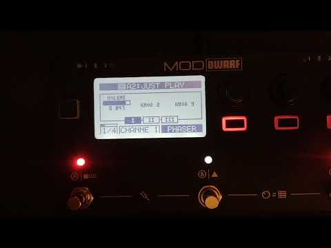

In the following video, if you watch the screen after the 'MOD" boot splash screen, you can see it first loads the “Default” pedalboard, then loads the previously selected “Just Play” pedalboard.

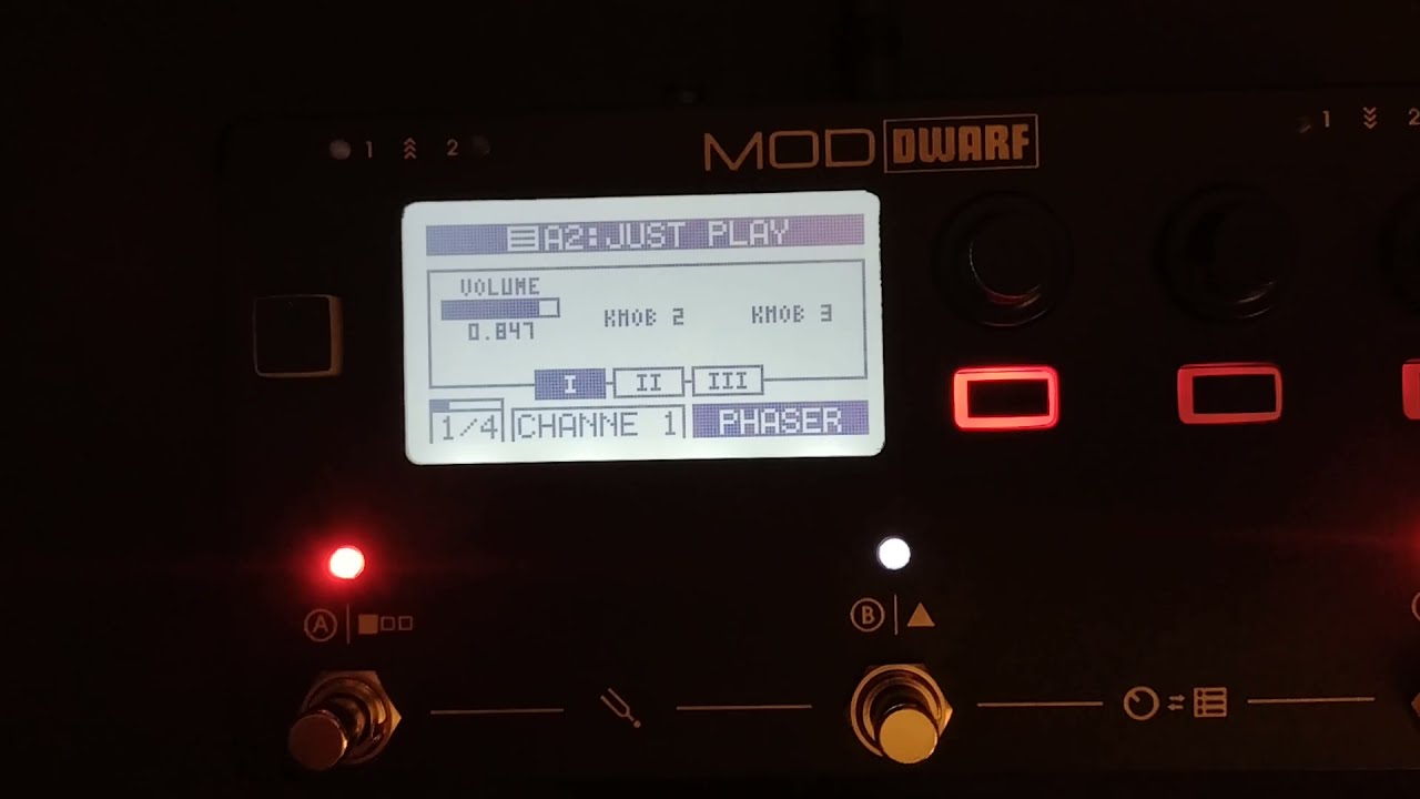

Here is a video after a failed boot, and a freeze issue.
