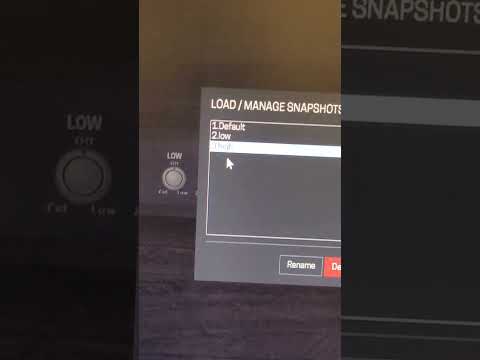

Hop very crude little vid.
Asks questions if you have any.
That is so awesome! I feel like demos of this type of functionality would be good selling points to certain demographics.
