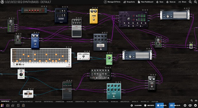

I’m using looping mostly without any syncing, but I’d like to be able to use it and a sequencer simultaneously with host sync-- but when I stop/start transport the looper glitches like crazy, repeating the first few notes multiple times while the sequencer just chugs along-- something about how if I hit the transport back on after turning it off, the difference between that and the loop start point makes it glitch… maybe… I’m not sure why it does it, it’s very irregular, I’ll try to get a recording of it.
The loop is synced to the transport and can’t understand it jumping around. Starting and stopping is likely to cause it to move unexpectedly. I need a good description of what you are trying to do.

What is generating the clock? Is there any MIDI clock anywhere in this setup?
no, just the Dwarf’s internal tempo tool and drum sequencer with host sync turned on
That should be pretty stable. I’ll try to reproduce here. I have a much simpler pedal board for host sync testing, but I’ll look at your board picture to see if something that you have in there will have any effect on the test.
Thank you for checking it out-- I really haven’t been using host sync because of it, but I’d love to. It happens on other boards as well, though I think all of them are fairly busy with various plugins, like this one…

I don’t have a fix yet, but I have replicated the bug. There must be an error in the calculations because all works well at 120 BPM, but fails at many other BPM settings. I’ll need to get my calculator out and check the computations by hand and see where the error is.
UPDATE: I found the bug and will release a new version soon.
