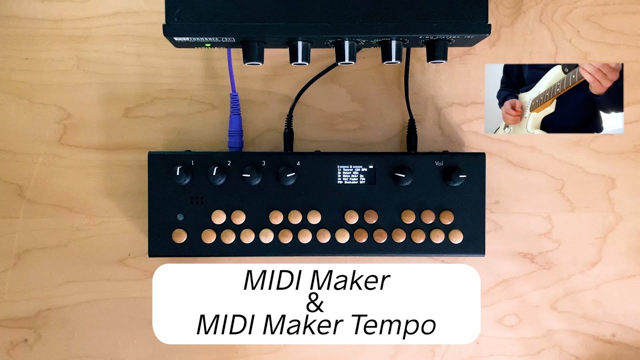

Interesting stuff here…
If the Organelle is able to do it with a “simple” Pd patch, surely the DuoX and Dwarf can do it even better without having to load a whole Cardinal patch?
the cardinal patch is just to get a cv quantizer (being able to set the scale too) and then convert it to MIDI.
would be quite doable to convert those into individual plugins, I brought up the cardinal plugin mostly because it is quick to experiment with.
on the organelle video we can see the audio to midi conversion does not try to keep track of note length, there is a dedicated parameter for it instead. not sure why it is this way, perhaps a trick to make it more reliable?
