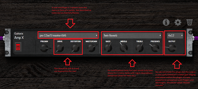

I already messaged @brummer some of my initial ideas.
Amp X already sounds very good and writing brand new code is likely unrealistic. My suggestion would be to repurpose what’s already there, in order to create 3 plugins (low, mid, and high gain amps) that would cover the needs of 90% of players as far as basic tones are concerned (and for all the other players, there’s AmpX, Alembic, Cream Machine, Onyx, Titan, Supersonic, etc.)
Since clean/edge of break up tones are where I exist most of the time, I did some initial testing (using Petrucci/Henson Neural DSP plugins as a reference - not to ‘copy’ them of course, but to get the idea for the gain ranges available in their “Clean” amps) and it turns out that creating an amp that would cover mostly clean sounds using Amp X should be rather straightforward:
I typed “in comparison” when talking about the output section in the picture above but I meant “in conjunction”. It almost makes sense anyway, but I’m pointing this out for the sake of clarity.
Leaving the Drive and Distortion controls, at 0 make the range of the Pregain (should probably be called “Gain” in the final version) lend itself very well to producing clean and the edge of breakup tones (up until like 3/4th of the way depending on the chosen Tube section). The amp can still get that hairy/distorted sound with the gain all the way up, and all in all, this seems to be working extremely well. As mentioned I did some testing with the Petrucci/Henson plugins, and there, the “Clean” amp behaves in a very similar way (the range of the gain knob is mostly clean and the amp gets dirty only when the gain is close to max).
When it comes to which tube sections/tone stacks to make available to the user, and how to name them, that would require some thinking. Tone stacks would be easier, something like Twin, J-45, AC-15 for clean. It’s probably best to use terms that are somewhat vague to give the user a good general idea of what they are working with, but not build false expectations that the “Twin” will be exactly like their Twin tube amp (call it “American” or “American Clean”, or something even more abstract like “Silver” for Fender, “Gold” for Marshall, “Red” for Vox instead, etc. the specific tone stacks can be mentioned in the amp’s description).
MOD already has great sounding and looking cabs in the store. Besides, it simply makes sense to the user these days, that amps should be “complete” (include preamp → tone stack → power amp) and no cab sim. Nothing against the Cream Machine but all the parts of the Amp X already work great so there’s no need to add that on top.
Mid and High gain amp would require a bit more testing, but this is how all the amps would look like in general:
The high gain amp could likely use an additional control (access to either Drive or Clean/Distortion that would be arbitrarily set for the other two amps).
When it comes to the naming convention, UI considerations, etc. I deffer back to you @James because this post is already long enough, but I’ve alluded to some of my initial ideas (I’m really trying not to use Neural DSP again as an example, but their stylistic choice of streamlining, simplifying, and not even referring to “real amps” but rather the “archetypes”, if you will, seem to resonate with players).
This one sparks joy! ![]()
do you see any way this could happen without adding new plugins?
Me too. I’m a big fan of the Cory Wong amp from Neural as well some amps from Amplitube such as the Fender SuperReverb as well as the Red Pig (Marshall Major clone) that I plan with very low gain to keep it mostly clean.
I agree with this. Since this set up would be pretty much aiming for a Fender Twin Reverb like tone (a staple which I think we should definitely have) it would be great if the controls closely resembled the ones on that amp. This would really help to reduce the onboarding confusion for players used to these amps. Maybe even adding reverb to the amp would make a lot of sense.
I second this. More recognisable names would help because most guitarists know the amps but don’t know the names of the preamps and poweramps.
I partially agree with this, however for some people, it might be nicer to just have a “delux reverb” or a “twin reverb” that has everything in one like the real thing. Preamp, Reverb, Poweramp and Cab. Although the IR cabsims are hard to beat
Maybe it makes sense just to focus on the clean one in the beginning
I really like them too. They all kinda look uniform but have their own style which I really like. Maybe me and Andre can come up with the kind of template and then the we can ask for inspiration from the commuinty for the colours, materials and textures. Or give assets for you guys to play around with
I don’t think that is possible without break backwards compatibility.
As it requires to redefine the range/amount of the controllers. Beside that it may be a good point to update the Guitarix tube simulations to the latest upstream for those new plugs.
