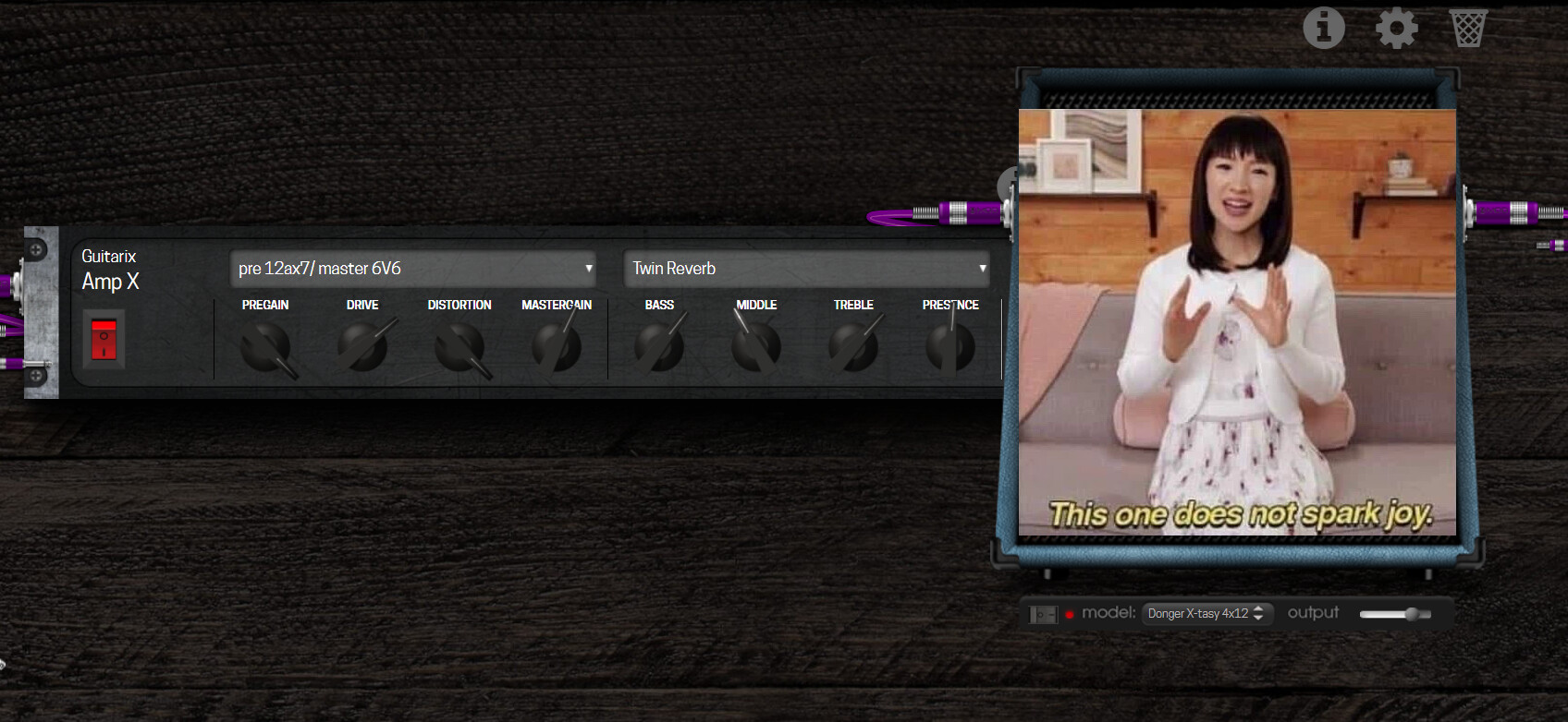

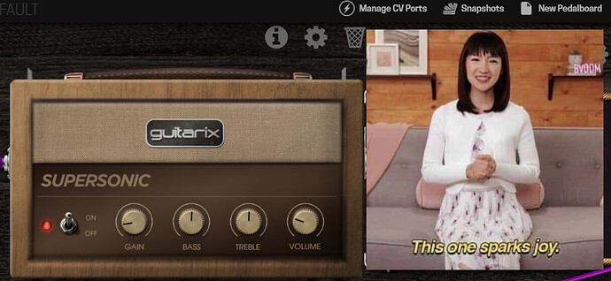

Supersonic was a great, fun, enjoyable, intuitive experience, but there are some tones this amp is not good at producing, namely the higher gain ones. I could use an Onyx for that (which is similarly user-friendly but more complex and more versatile) but that wouldn’t illustrate what I’m trying to showcase, so I used another plugin by the developer of Supersonic, the Amp X.
The tone stack and cab parts of it are fairly self-explanatory, but it took me a very long time to get a feel for how the Pregain, Drive, Distortion (I think it’s called ‘Clean/Distortion’ on the Linux version, which while arguably less elegant is a bit easier to understand), and Mastergain interact with each other. Also, given the insane range on all the controls, I had to do some very drastic gain reduction post-amp and I think I gave myself some hearing loss regardless.
Anyway, I finally figured out that the drastic gain reduction combined with cranking the pre/power amp portion of the plugin can produce very good hard/rock and/or metal tones but I can then still use a… Fender Twin tone stack on top of it, which I guess is funny and could be done in theory in the analog world, but it is just about the most unintuitive thing I’ve ever experienced in all the years of my digital guitar-tone chasing.
