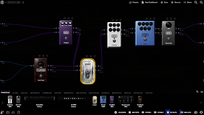

I use just this one pedalboard most of the time, can’t be shared since it has a couple of unstable plugins, but here’s a screenshot:
