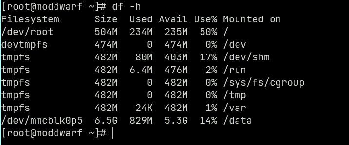

@xko The only reason it should fail to save is if the filesystem is too full. Can you determine how much available space you have is?
I donāt think this is the case. /data is only 14% full
