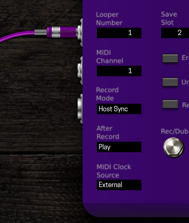

Dwarf is synced to external seqencer:
That should be fine. The external port only sends clock info to the LP3. The MIDI in connector can send commands to the LP3 via note messages. So, this seems really strange that disconnecting the sequencer will matter because that will only impact host sync. Let me connect my drum machine and see if I get the same result. If not, I may need to enable some debugging to get a picture of what is happening.
To be precise - not disconnecting, just pressing Stop on it.
Also my PB has midi loopback and a lot of midi processing. Maybe I should retry on clean PB, will update when this done.
Ok, I can reproduce this issue. This is a strange one to be sure as I’ve never tried this combination in the past. I’ll work on this and see where the issue is.
