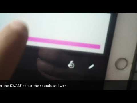

Thank you for replying, I try to explain in the video what happens and I apologize for my bad English, however I wrote something. Please note that the GUI is not active and that DWARF receives MIDI messages during programming. I use an iPad connected via a USB HUB and the software is Camelot. Let me know what you think, I just wish I could work with what you see on the video.
