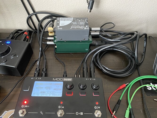

Like many others, I have been locked into a battle with the dwarf over noise.
Generally I don’t bother with trying to squash it because I am not a music professional by any stretch of the word, so the noise issue I just learned to live with by making all my tracks sound like they’re underwater.
However, I was super interested in the troubleshooting aspect of the issue, and saw some really awesome tips and tricks being shared.
I had some cash set aside from a birthday and all that, and just decided to buy a couple of devices from radial.
What you see there are 2 devices from radial.
The green on is a passive stereo DI box with pad/lift options
The grey is a passive stereo isolator with pad/lift.
https://www.amazon.com/dp/B00U2WG1SQ/ref=cm_sw_r_cp_api_glt_fabc_3S7S717HWTD1T6BRSMHN?_encoding=UTF8&psc=1
Now I don’t recommend throwing money at the problem if you have the know how to fix it on your own.
My particular situation seemed to need it.

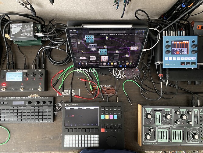

My bluebox is not a balanced mixer, and I send tracks direct from the mixer into the dwarf.
This has been causing significant noise, at least my fix has solved the issue so I am making a rather large assumption on the root of the issue.
I have also been struggling with getting enough signal out of my dwarf, and it did not matter much on what sort of internal gain settings I messed with. I love the sound of the pedal, but had been getting frustrated with trying to get the volume I needed from it.
I am running a stereo breakout from the Cue out on my bluebox, and into the passive DI box to convert the signal from unbalanced to balanced for the dwarf input. I applied gain lift to the signal, and used XLR to TRS adaptors to the inputs of the dwarf.
From the dwarf, I used short TRS cables to connect to the isolator, applied ground lift, and then plugged in 6.3mm to 3.5mm trs cables from the output of the isolator back into the mixer on channels 5 and 6.
For the first time, my “Main” track on my mixer is silent. No ghost noise, no whine, no gain issue. Just pure, clean audio.

A big issue with the bluebox is how cramped the rear of the device is. I have to spend a lot of time finding cables with super thin 3.5mm housing sleeves, otherwise ports get blocked off from use on the back.
That was a large reason why I chose the solution I did. I know what cables I have and that they work with my mixer specifically.
Even now with my solution I lost an output on the mixer due to a cable that is improperly sized for the output jack spacing :confused:
So now the search for a slim 3.5mm housing to 6.3 stereo breakout cable will commence.
I have one more cable connection test I need to do today to see if I can create a solution to let me use all of my mixer I/O’s again.

Thanks so much for posting this. I’m having a hard time understanding your path in full. Tried following your cables in the but didn’t quite get all the routing right. This is as much as I figured out (from pic and your post):
Source => PRO-DI => Dwarf => Stagebug => Mixer
Is that it? If not, could you describe it?
I myself stand by the Radial Stagebug with all of my heart. It was my best stage friend for years. Other than doing conversions to/from balanced and unbalanced in all possible combinations, it is really sturdy. (Disclaimer: I am not affiliated with Radial Engineering.)
That being said, passive DI Boxes most likely cause some drop in the signal. They employ transformers for impedance conversion and that bites off some of the its strength. The solution to that are active DI boxes, most of which have no transformers. They usually employ batteries instead of a power supply, so as to avoid noise from a power supply.
(I used hand-built active DI boxes for some time. At one time I recorded in a studio and the engineer liked it so much that it bought the two units I was using right there on the spot. Not sure where that schematic is, but it was an easy build, actually.)
Fully in agreement with @cbix here. That might as well be the reason, and I too would recommend a different, analog mixer, footprint allowing. I used a 12-channel Mackie for years, it was really good.
Going from balanced to unbalanced per se is not the issue. It can happen along the chain, but too many passive devices will have a detrimental effect – not in quality if they are good, but in strength.
It might be the case that you can think of your signal flow in a way that your Dwarf sits as an effects bus, so that you can dial it in from the mixer (if that’s not what you’re already doing.)

You are correct in my signal path, I just isolated the dwarf in my chain since that was what I was testing for noise.
I’m still dealing with a bit of noise, but it’s really reduced, and I have a few more tests I’m going to run today to see if I can isolate the last bits of the noise.
Since I’m using my IPad to record, it’s at the very end of my chain.
My mixer is plugged into my audio interface, and that was a cheap interface from behringer and it’s pretty noisy.
On my last track, I was diligent to record stems directly into my mixer, as well as a master on my iPad.
I’m gonna listen to each stem today and see if the noise is present in my chain before the mixer, or if it’s from the interface to iPad chain.
My iPad is using a cheap powered port expander, and I’m thinking there might be some RF noise from the USB.
My interface is directly powered with a power supply plugged into my power conditioner, and I applied a USB cable with a ferrite choke to the usb audio out. I heard ferrite chokes in a line help attenuate RF noise (but I can’t confirm if that’s true or not.
I’m still tracking down where the noise is coming from.
I’m thinking it’s between the mixer and iPad.
My cans and monitors are dead silent when listening direct, but as soon as the recording is finished on the iPad, there is a hiss there.
