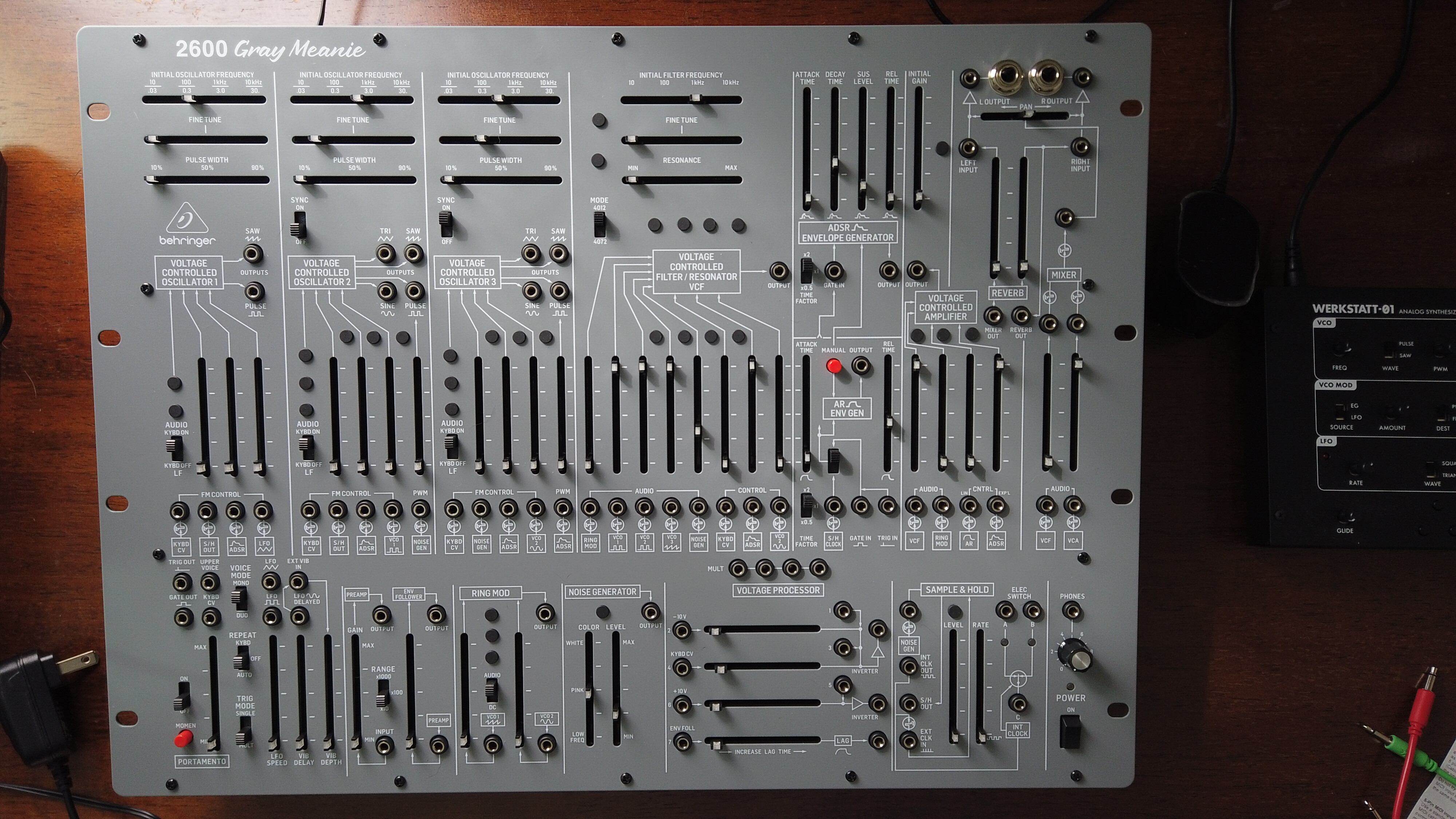

Since I need to rearrange my set up to work with this monster 2600 clone, I will just tear everything down and start over again.
This thing is a lot of fun, but it’s not exactly table friendly….

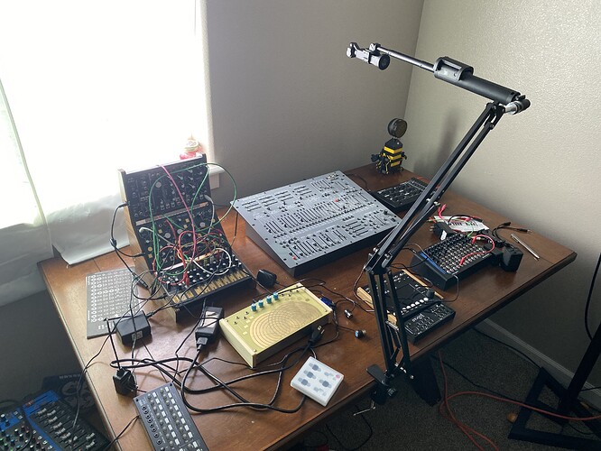

Thinking about it more, my big poly synths are plugged into a different outlet than the rest of my gear, and I’m wondering if it really a ground loop I’m hearing.
I won’t be able to test anything for a couple of days, but I’m gonna move stuff around and test it this week.

Hey Frank,
So I’m still plugging away at this issue today.
I’ve made sure to connect all of my gear into one outlet and the noise persists.
I’ve addressed my mixer and messed with its compressor settings, no luck (other than sound quality improvement) with eliminating the hiss.
I’ve attempted to apply high cut shelf’s to the master track, filters, anything, and to no avail.
The audio is definitely sounding a lot more crisp though: Dropbox
You can hear that hiss still when it should be quiet.
I will let you know that this hiss persists whether the dwarf is powered or not.
My mixer shows dead silence, and so does my iPad.
I’ve tinkered with everything my limited working know how can accomplish at the moment.
Since I’m stumped but pretty happy with the progress made on the noise issue (you can hear the audio difference listening to my Mod dwarf track versus anything I’ve uploaded since that track) I’ve started working on building my second set up for video demonstrations.
I’m digging the camera view so far:

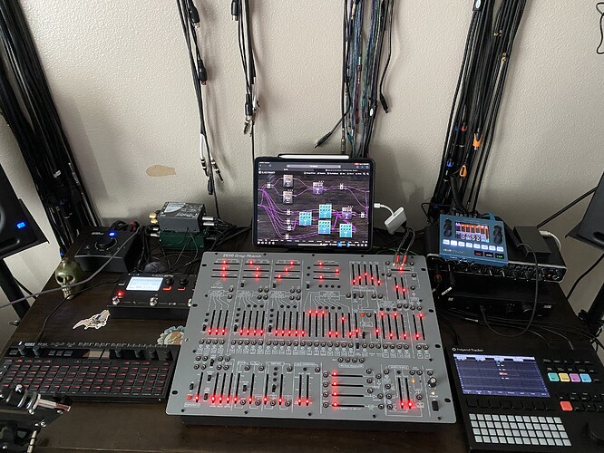

I’m really stumped because I have a bunch of gear in my set up, but nothing USB powered at all at this time. Everything has its own wall wart hooked into my power conditioners.
At this point I’m considering finding an app that removes noise from recordings and go from there.
Either way, I’ve had massive amounts of improvements to the fidelity of my recordings and I’m pretty close to just forgiving the hiss and moving forward.
I have a hard time letting go of a problem if I know there is a solution out there somewhere, so although I want to say I’m happy with my situation, the truth is that I’ll always be trying to figure out how to solve this problem lol
