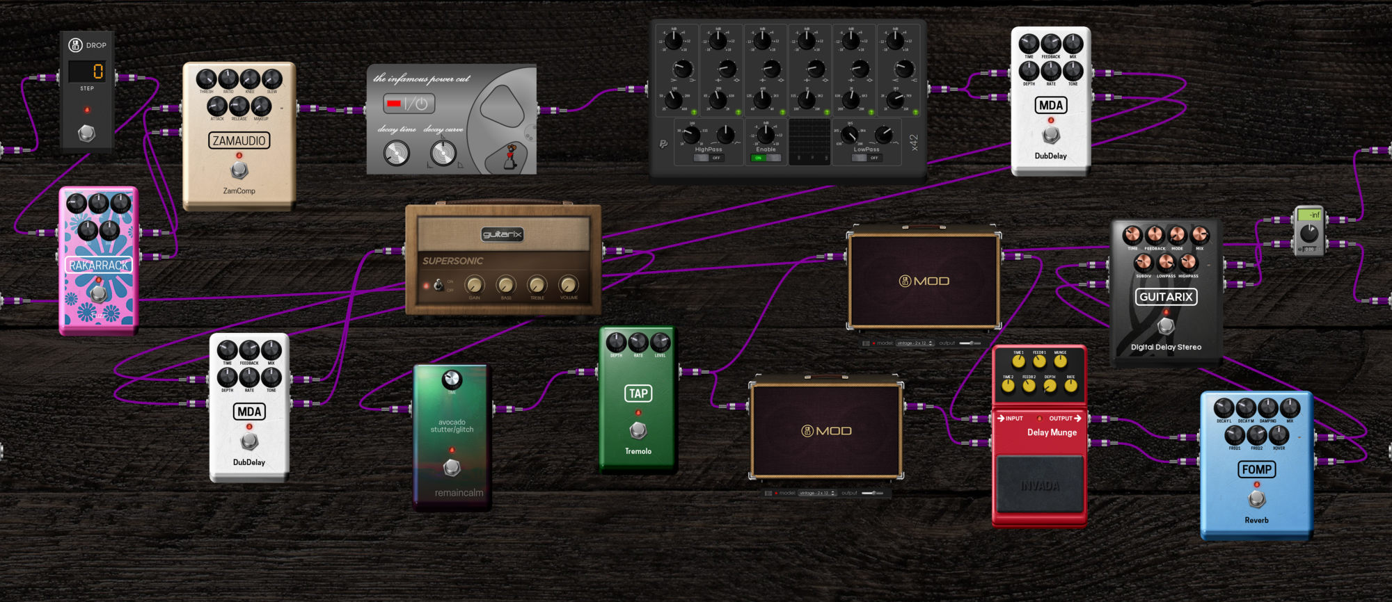

One weird thing: In my old Mod Duo I could split the signal running channel 1 into channel 2 and then a bunch of plug in in between out to 2’s output. I just stumbled on something (who knows, maybe I’m an idiot and it’s been possible all along) but if I run a path out channel 1 then have effects in channel 2 as a loop so to speak but in the app I bypass that and connect input 2 straight to output 2 the loop with other effects is active. Very interesting. Possibly a way around the issue? I dunno’. It’s not the same for sure but if it works…

Somewhat of a work around but not perfect (the volume pedal is only active on the loop). Not what my Mod could do but I’m sure we’ll work it out:

So I recreated my old Mod Duo board with different plug ins that weren’t misbehaving and had to use two less plug ins (???) because this was perilously close on CPU. I’d much prefer having my old board with the wah and chorus added and the CPU was lower but maybe with the new bug fix:
This is the old Mod Duo set up:
FWIW that dual cab patch I posted won’t survive with more than a few effects active. As soon as I engaged the octave drop CPU hell broke loose and lots of artifacts. I’m gonna’ attempt a workaround.
