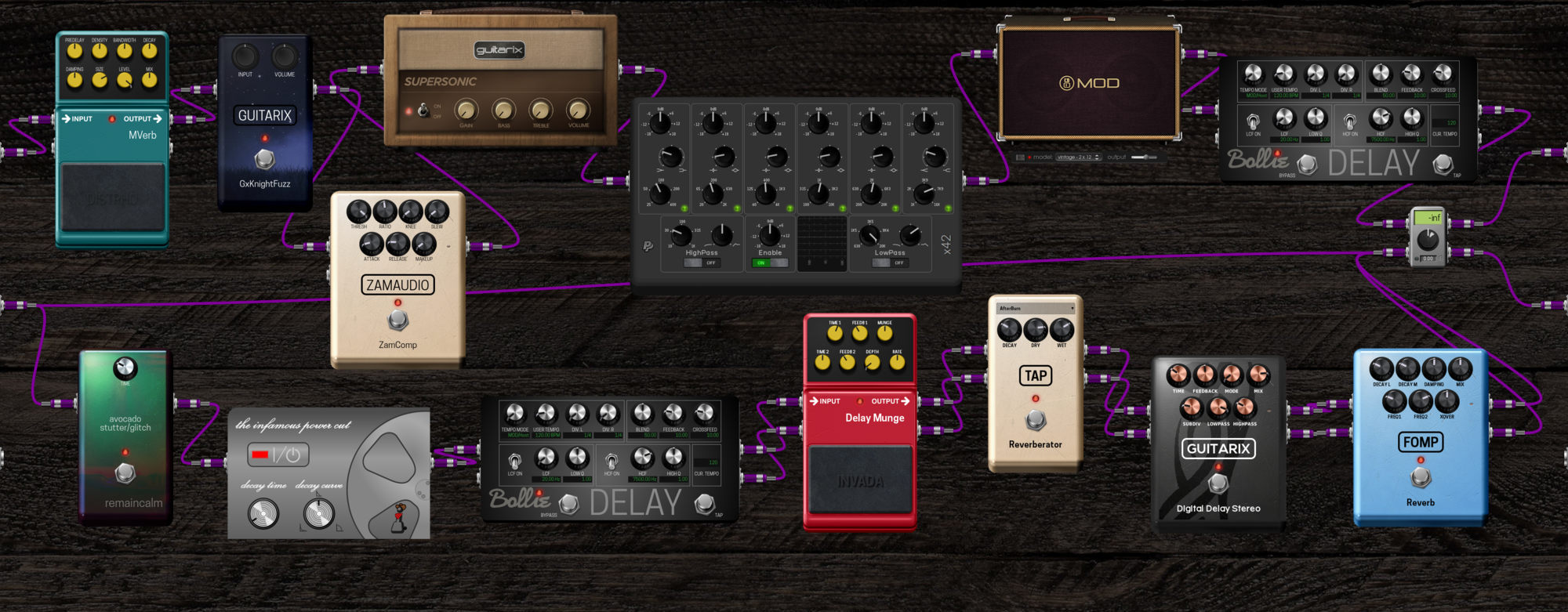

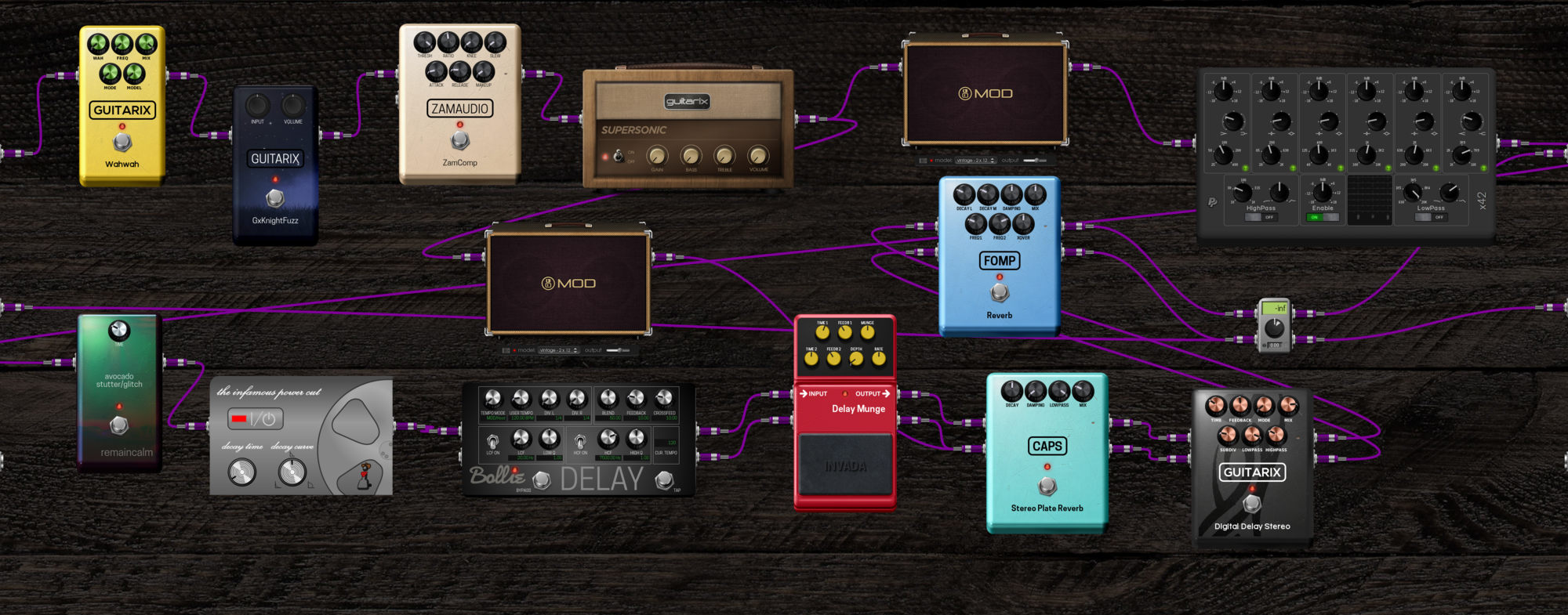

I’m trying to decipher the pedalboard. I notice there are a few points where the signal from the first chain (in1 -> out2) is being inserted into the second chain (in2 -> out2)
Video 1 - (red line)
Video 2 - (red line)
Is that intentional? I’m just thinking it may make it difficult to isolate whether the individual chains are working correctly like this
Yes, for now that was intentional because I couldn’t get my old signal path–from output 1 into input 2 (and effect loop to other pedals) to work like it did with my Mod Duo. There’s many way you can do this such as direct from input 2 to output 2, but I was trying to get the wet effects in there. Right now I’m rebuilding the whole thing from scratch with dry effects (dirt, fuzz, compression and EQ) to output 1 and all wet effects after the loop to output 2 keeping them separate. So far that’s not working either (well it was but I’m getting red on output 1 without even playing and thus no signal). Frustrating.
