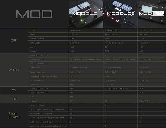

Hi @khz
The image that you shared above has some info regarding the Dwarf audio outputs that differs from the info found on the Dwarf’s technical specifications wiki page.
This is a very important technical spec. Which one is correct? Hopefully the wiki is the correct one since I’ve never seen the above image before.
Hy @rogeriocouto
I would trust the wiki more than the picture.
Yes some things are not right (anymore) on the picture.
But the data regarding CPU/RAM/Memory should still be correct.
Every day I learn; thanks @falkTX !
Much appreciated!
@rogeriocouto, @khz is right. Trust always more on the wiki and current version of the website! And even that is outdated sometimes, but not on tech specs.
The image that @khz shared before comparing the devices is outdated especially in the case of the Dwarf.
As far as I know, that table was created even before I joined MOD, which means quite a bit before any Dwarf was shipped, so it was still in development.
If it does not make much of a time commitment could you bring the table (from the picture) to the current state and adjust it if necessary when there are new features?
The table on your website for direct comparison of the devices would be IMHO helpful for new people who are interested in the mod.
Indeed, altough that table was shared for a different purpose I believe.
I’m not sure where/who is/have the original file that can be moded, but I will ask around
