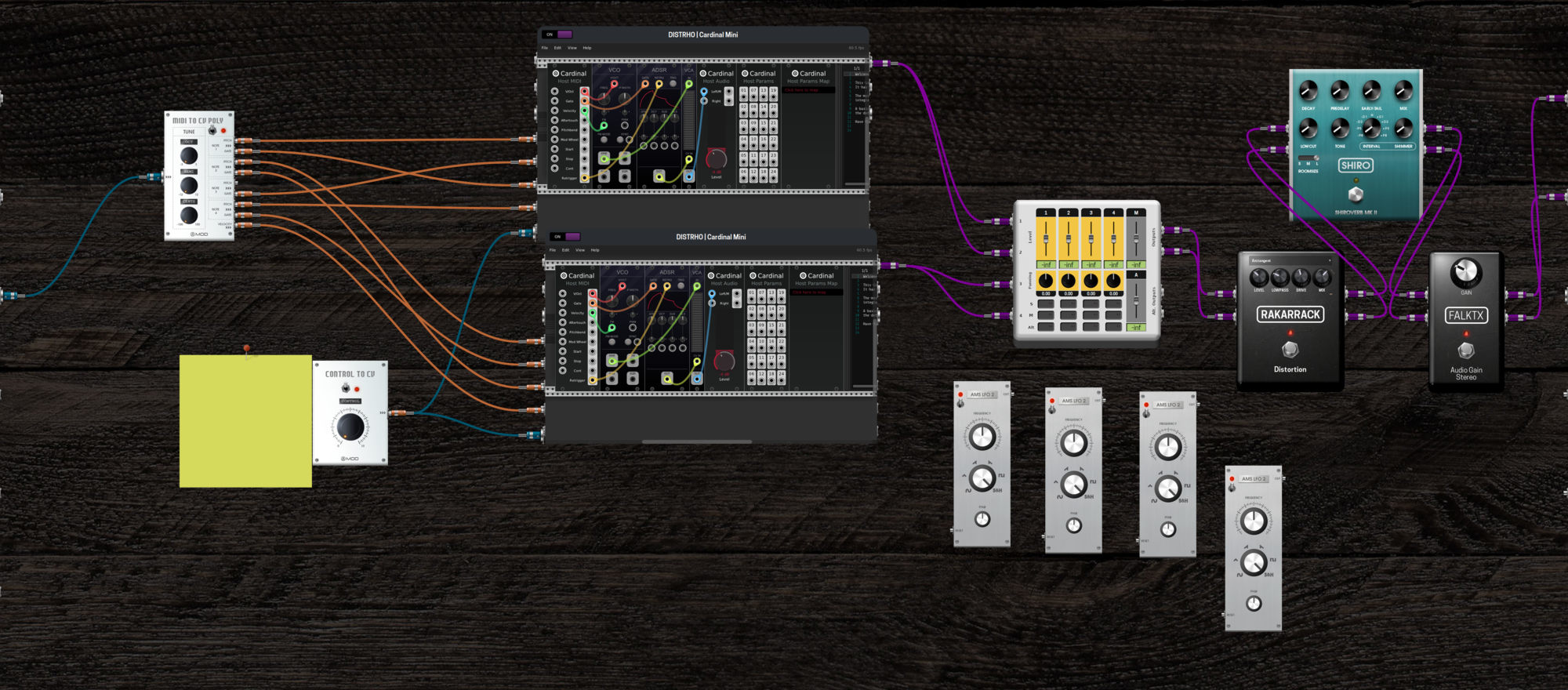

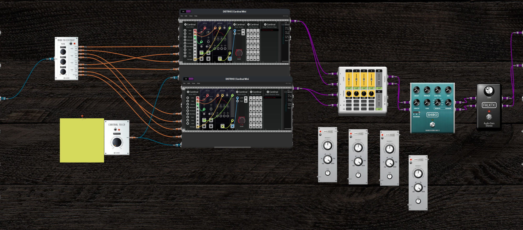

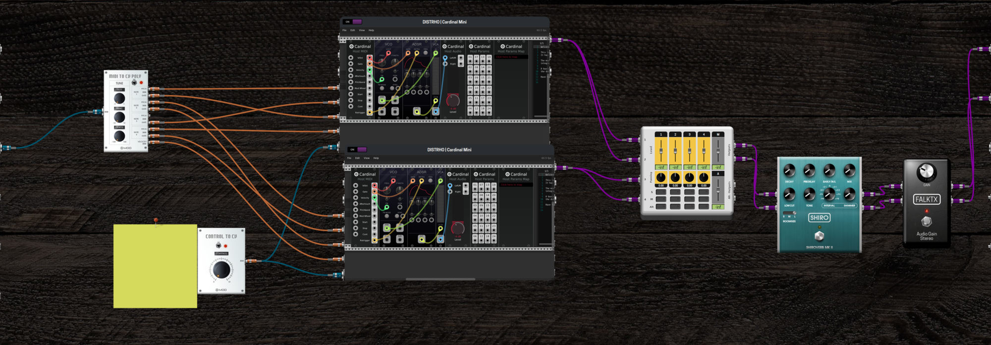

I now have a nice infinite decay reverb insanity going on :smiley:
Using about 33% of my DuoX cpu.
