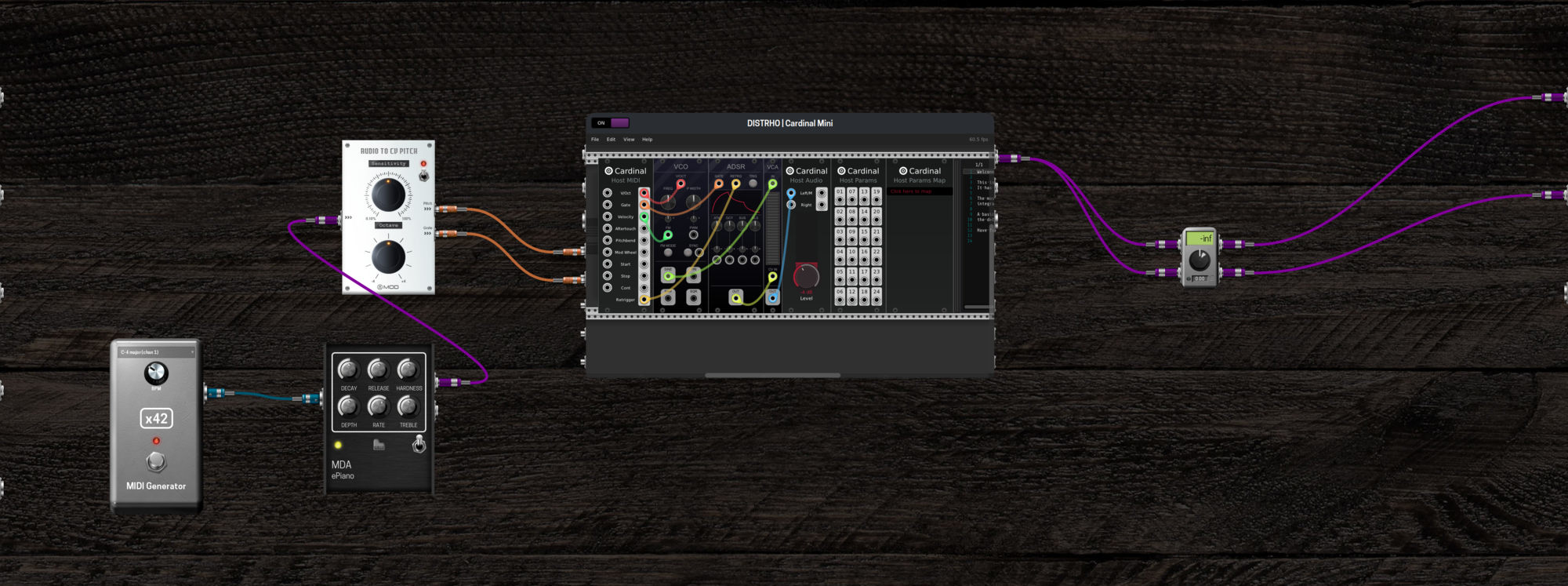

@Steve1 can you be more clear on what you are trying to do?
you can use audio 2 cv pitch module before cardinal and send the cv outs into Cardinal (regular or Mini) or use the audio2cvpitch from within Cardinal (but a bit wasteful since it being external does the same)
something like this
Demonstrating sending CV pitch into Cardinal Mini.
