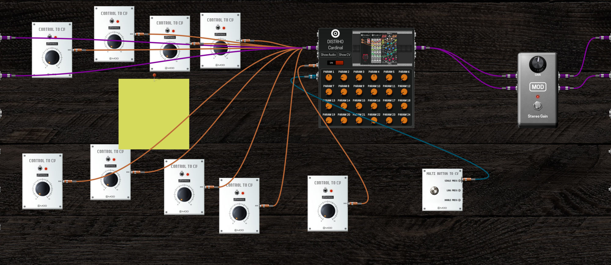

SPECTRAL now working a treat on the MOD DUO X - all mapped and good to enjoy here folks.
More to follow - VERY happy about this ![]()
This one actually works
why the many control to cv? the âhost paramsâ module provides the knobs as a cv source to patch in to other things.
Ah - didnât know that! Only had this thing a few days ![]()
A few others up there now - the time stretcher and resonator options didnât work out.
Still - theyâre there an mapped to knobs on the MOD DUO X so hope people have some fun sonic mangling with them
@falkTX Understand what you mean now - Iâd tried that but that feature doesnât seem to work on the MOD version of Cardinal, whereas using CV does.
Except thatâs exactly what I showed in my screenshot and it works great for me.
Odd - tried it again with a more complex setup today and worked fine.
