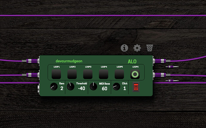

Actually one question. I thought Loop 6 was set to always overdub, but I can’t get that to work.
I want to be able to have my delay trails overlap back on the beat one of a bar, which the other tracks don’t do, but Loop 6 only seems to do one repeat - no tape on tape style? Is there something I’m missing?

For the overdub, try routing the output of ALO back into the input. It’s a bit odd, i know, but it allows you to have fx on the output feeding back through the looper.

Just to confirm. Loop 6 does not automatically allow for overdubbing?
There is no overdub mode in Alo? Or am I just missing how to use it?
S.
@S_Righteous if you send the output back through the input, you can add new input will getting the existing loop, which is overdubbing. Maybe i need to rethink this
Oh I see what you are saying now.
Loop 6 is just a delay. So if you send the output back in, the delay keeps looping.
The downside is that all loops will be fed back into that loop.
The other loops don’t accept new input, but their output will feedback.
Actually the most simple update that would make this more flexible is separate outputs for each loop, then you can feedback #6, and or have separate effects on each loop output.
@S_Righteous true… in the meantime you could use a separate instance for overdubbing
