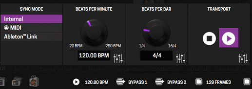

I think it’s on (see picture, the Mod Duo X looks different from what I remember of the Mod Duo).

if you put an x42 step sequencer on your board, you’ll be able to see for sure if global bpm is running, since it will visibly cycle through the steps.
Good point,
I just did that, with the x42 Sequencer, Set it up to Hot Sync, and when I change the global temp, it shows up the sequencer…
So it’s something else …
and it’s just me… It really have been me, because I can make it work. Not sure what I missed initially, but definitely linked to that Global Tempo once again.
