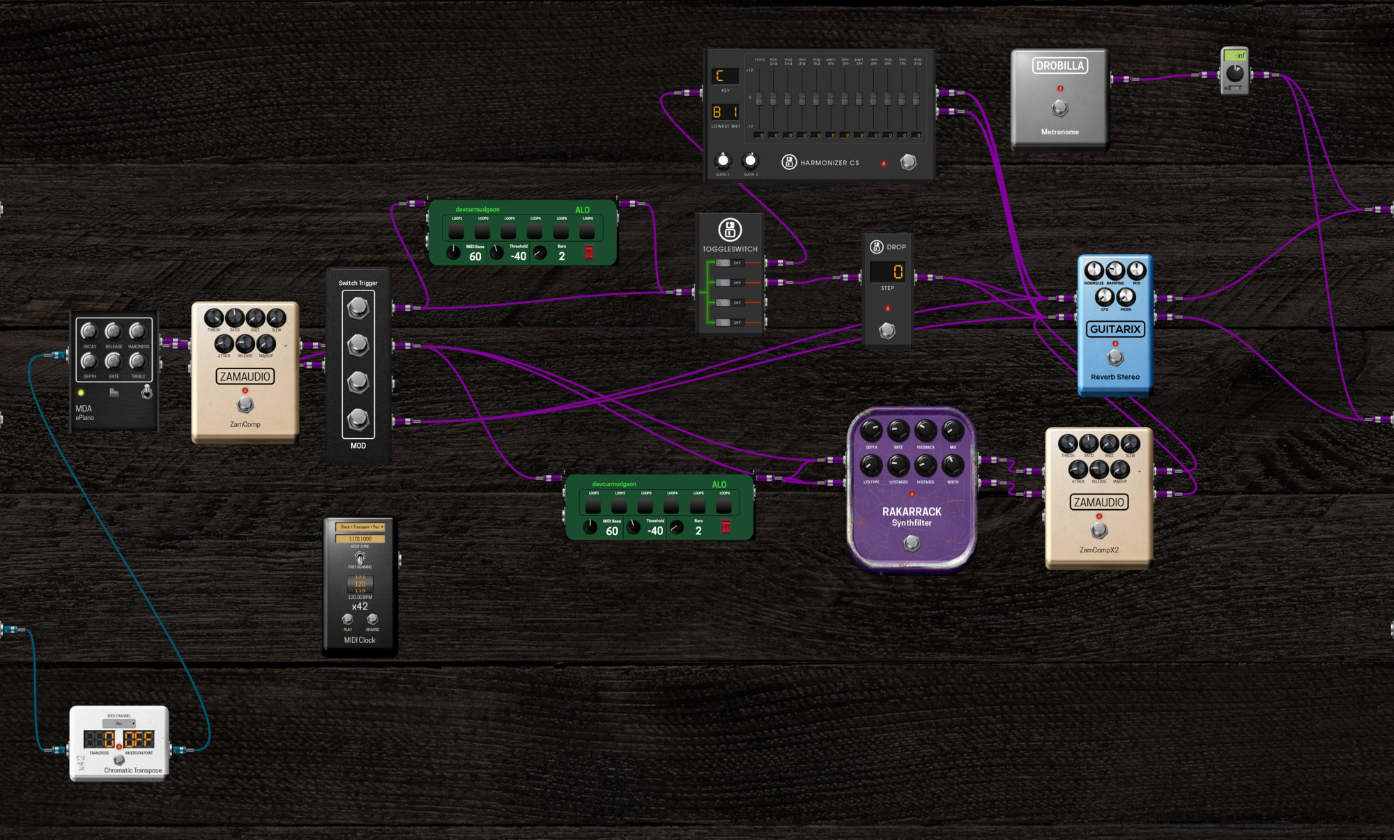

fwiw in my use-case I’m running multiple ALO instances in parallel: each instance can have a different [BARS] setting, so I can make a four-bar phrase loop over two repeats of a two-bar phrase, for example.

Our first live performance using Alo looper on MOD Duo
We could have positioned the cameras better, but:
  • 2 bar acoustic guitar loop to kick off the song, runs all the way through (on MOD channel 1)
  • 4 bar lead guitar loop recorded before the drums kick in (channel 2) then Andy switches to bass guitar
  • click track sent to headphones
  • once we get going we have the 2 loops in sync with the click, plus live drums, bass, guitar and vocal.
  • Andy drops the guitar loop in and out using Keith McMillen 12 step
  • all tracks recorded separately and then mixed afterwards (no overdubs)
With a bit more wiring we should be able to loop bass, acoustic and both electric guitars, all at the same time. Next time I’ll be sure to include footage of the Duo doing its magic :slight_smile:
