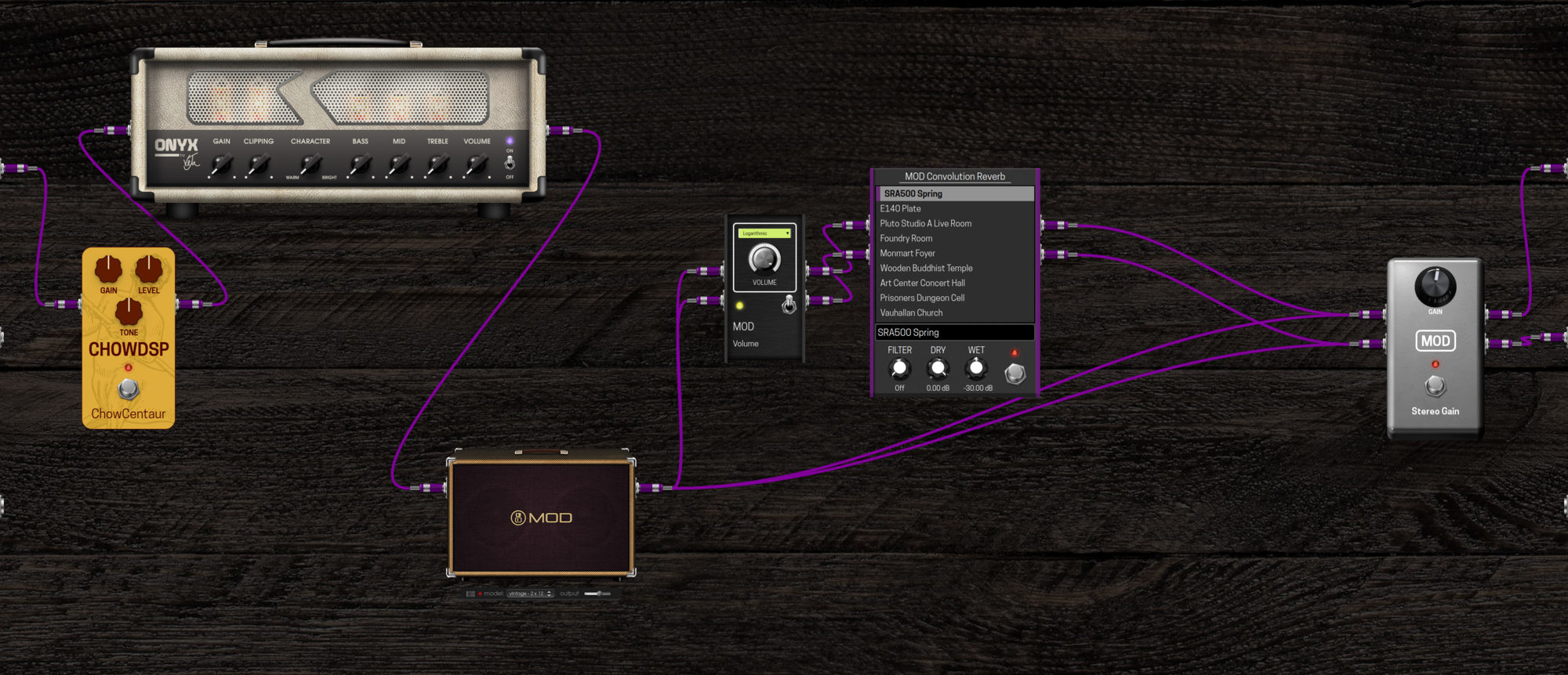

Same problem here involving the MOD Convolution Reverb,when I activate the CHOWDSP it jumps from 65% to 100% …Here is the pedalboard:
Can reproduce this with some tweaking on the PB, thanks!
One thing that I see is that pushing the average CPU load above 70% makes it jump a bit, but if it is always below 70% I dont see any jumps.
are you using the chow in neural mode? This eats up much more than standard.
It happens in both modes.
this is not so much related to cpu usage, but jump in them.
cpu load jumping from 75% to 96% is certainly not normal on a full realtime system. the load is meant to be consistent, assuming the PB is also not changing too (bypassing some plugins can reduce load if they implement a custom bypass, like it is the case of chow centaur).
this is definitely a bug that needs to be dug into and resolved.

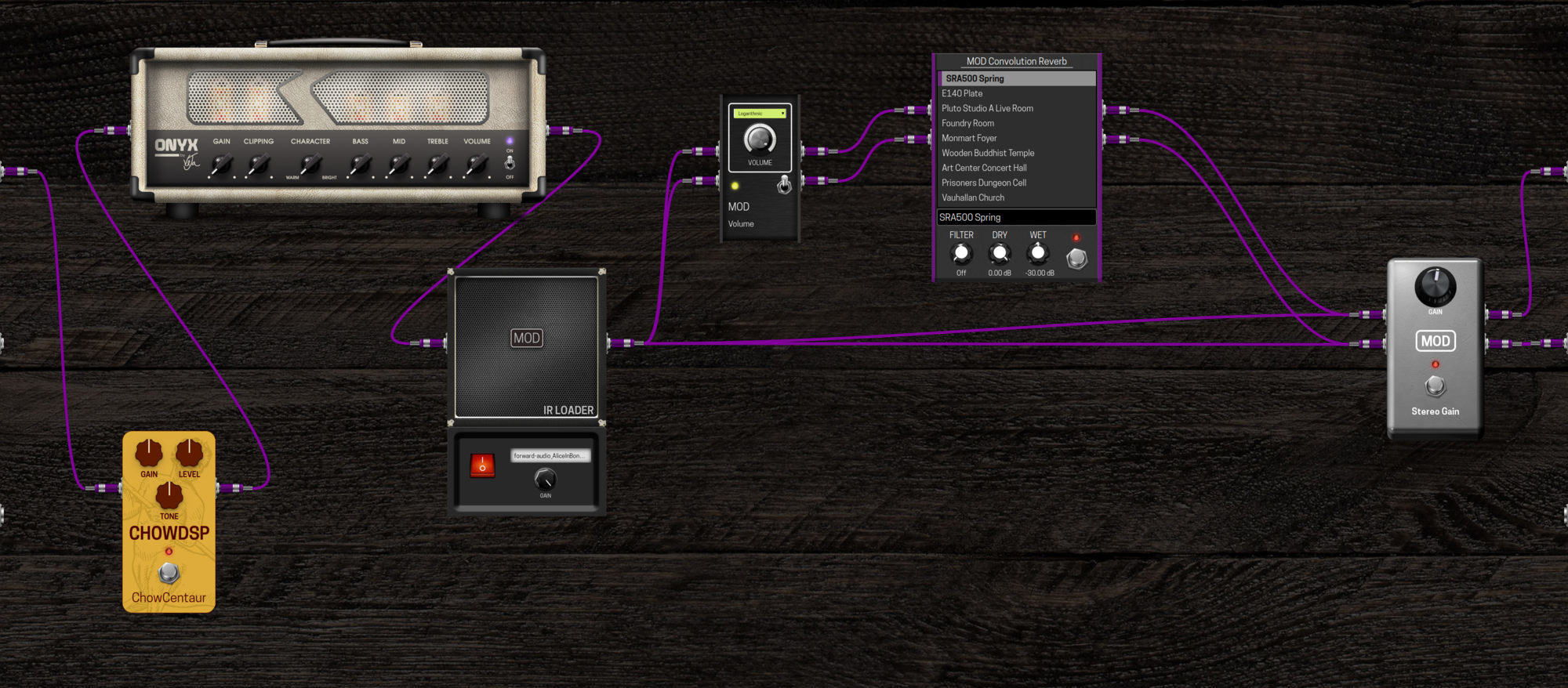

Don’t know if it helps, here is another exemple:
Same Pedalboard with the MOD Vintage Cab, same problem in High fidelity mode, no problem in Normal fidelity mode, less CPU of course but no jumps, stays under 60%.
