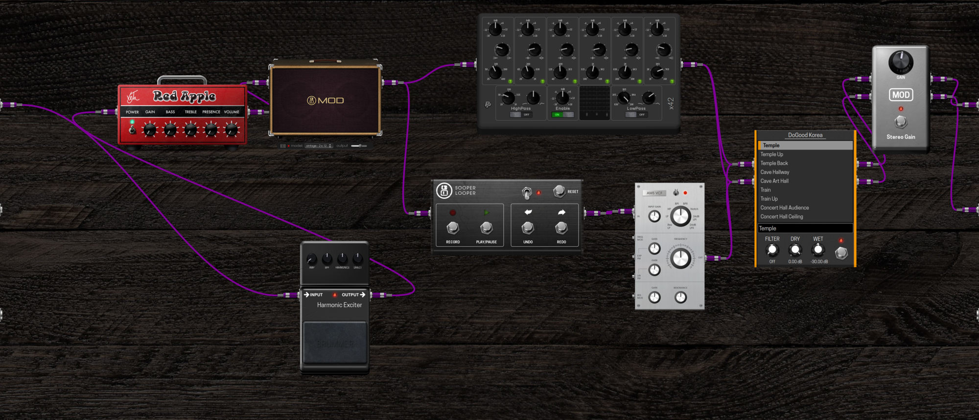

I think I have a lead.
I noticed that the number of x runs increases each time the pedalboard is changed and that is what causes the cpu usage peaks.
When I load the pedalboard with the Silo reverb for the fist time cpu usage is at 60% and X runs at 13.
Each time I load a new pedalboard cpu usage increase and X run too up to more than 200 for the same pedalboard! Of course the audio drops appear and I can’t activate any effect without cpu drop to 100%
@falkTX Is this normal?
for sure not normal. but a great starting point to investigate further, thanks.
the both photos above are for the same pedalboard !
The first photo is when I load the pedalboard just after having power up the Mod Duo X and the second after opening 6 or 7 differents pedalboards.
@falkTX
I’m playing with the silo reverb and many plugin since 30 minutes without any audio drops. But as soon I change IR in the silo effect XRUNS and CPU usage increase until audio drops appear.
I think it’s a issue that you can easily recreate at home.

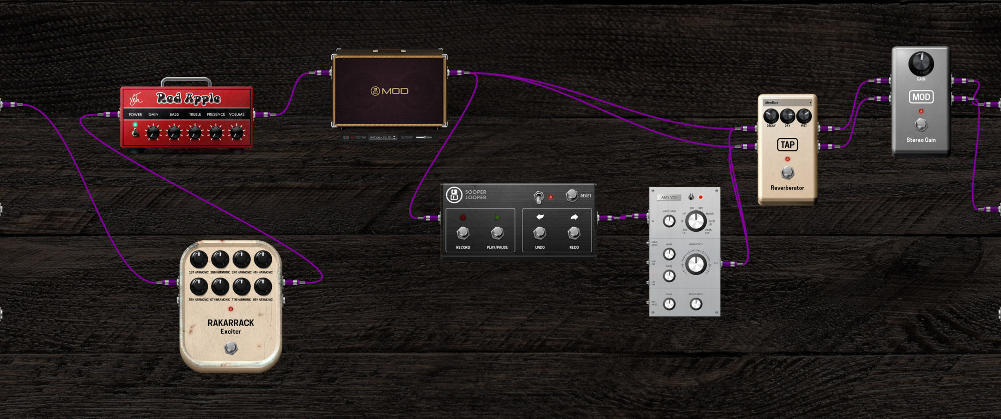

I got rid od rkr exciter and the CPU level dropped significantly. I added also portal which lowered CPU by about 10%.
