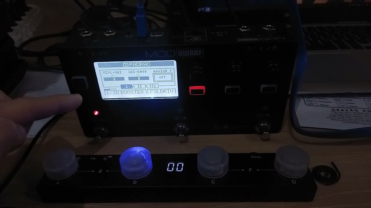

I’m developing a plugin for show the on off state. Maybe it could be useful for you. Its name is “gossiper”, because it tells you what is happening :laughing:
If someone is interested in, there is a preview:
As you can see on the video, there is a parameter on screen. Because of it, it’s possible to show the alerts. Then, this parameter exists just for enable the hmi popup presentation.
I added four of parameters like this, then I see the popus on four distinct pages.
For me, just parameters is sufficient, but Is four sufficient for the community?
If someone is interested in, please contact me. Would be great if someone can test it too.

Yes. It is a problem: as you can see on the bellow link, you need to sacrifice some of your parameters with a parameter that enables it’s plugin shows message on the current page. So, on your example, if no one of the parameters are from the plugin that will showing the popup, there isn’t possible to it show any popup
There is a limitation: you need to sacrifice a parameter slot on the screen for each plugin that needs showing popups.
A possible alternative would be if the gossipers talk to each other at the background to enforce that everyone gossipers gossip its and their stuffs, something like Portal does: two distinct pedals without be connected each other talk between each other on background.

Here you can see the limitation:
oh ! :flushed:
So that makes the HMI Widget pretty useless, no ? If there is already something showing the state of the plugin on the screen, why bother having a popup ?

Not quite - if I understad it correctly, you have to sacrifice one “parameter slot”, but then you get popup messages for four different switches.
Mmm… but we have now all the knowledge missing at that time to avoid this problem : if the ModOS is handling this instead of the plugin it could chose to deactivate it by default. Then, since there is already an advanced panel for each plugin, the user could enable the interaction with the screen and not bothered with popups not wanted. Am I missing something ? @falkTX ?
You have to sacrifice one parameter slot on each sub-page of each page, if you want to have this popup anywhere you are inside your setup.
