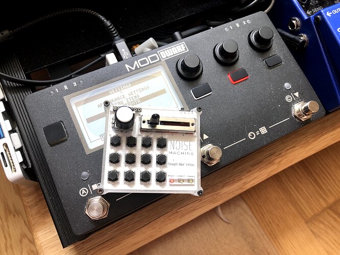

Hello, I wonder if it is possible to use a BLE midi controller with a Dwarf. I have on my Dwarf a current bluetooth dongle connected. The BLE controller is a Noise Machine. Would be cool if you could bring them together. Does anyone have an idea?

Of course I am also +1 for that feature… But I have found a solution. I just go with the Noise Machine into a CME Widi Jack and then connect that via the TRS Midi In to the Dwarf. Works great (after I had to puzzle a bit how to get the latest firmware on the Jack).
