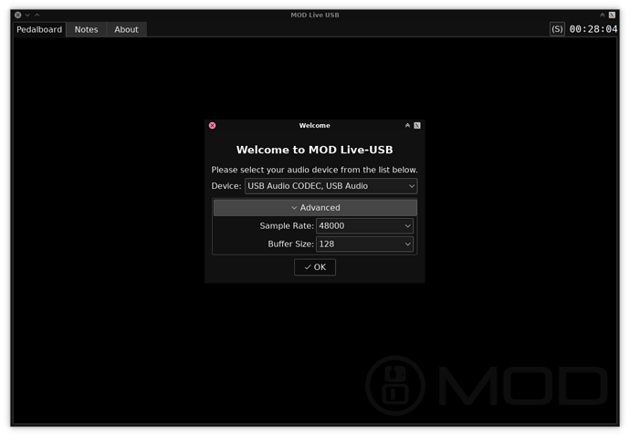

I am adding a sound device selector.
EDIT: uploaded new build that includes this.

And the Live-USB now with many more things that will actually make it usable.
Adjusting integrated soundcard levels is something still missing.
Work-around is to open a terminal via ctrl+alt+t and run alsamixer.

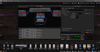

Got v3 working on my Linux desktop. More things to change than with v1. E.g. had to unpack rootfs.ext2.
Switched to jack netone for the transport between desktop and mod-live.
With rt-kernel and fast jack settings, the latency is low (5.3ms round trip in “bypassed” mod-live). Xruns are audible and happen at low CPU usage, this is probably different for the real Live-USB.
The container runs in jack “sync” mode, to minimize latency, so xruns are more audible than normal MOD unit usage. The 5.3ms is exactly expected of 128 frames at 48kHz, great that the netjack doesnt add more!
btw I am going with “sync” mode on because there is no possibility to install new plugins on the live-usb, so we are mostly safe when it comes to usage of them. (I did find that Filta can easily produce loud noise, will investigate later)
