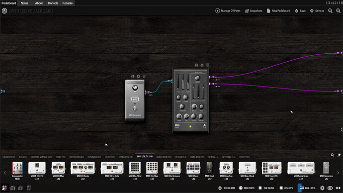

screenshot from within qemu (I did test on real hardware as well)
