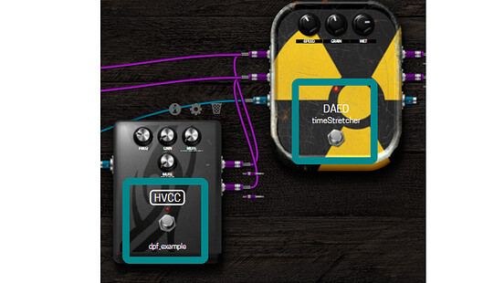

The one on top is timestretcher exported with ./camomile
The one below is with DPF via hvcc . Precisely https://github.com/Wasted-Audio/hvcc/tree/develop/examples/dpf
So good to see still the Heavy compiler still maintained , alive and rocking , with super easy export from pd patch-> dpf project → lv2 plugin .
Hvcc still inherits his older version limitations but its cool to see the project going and adding python3 and dpf to the mix .
