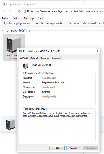

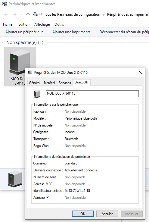

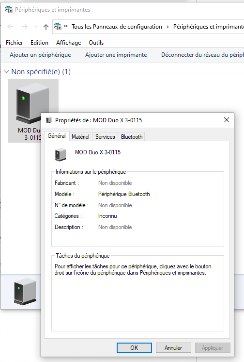

So I tried to connect with my computer and it works only with one bluetooth dongle, the Asus BT400
It works but it’s very slow…

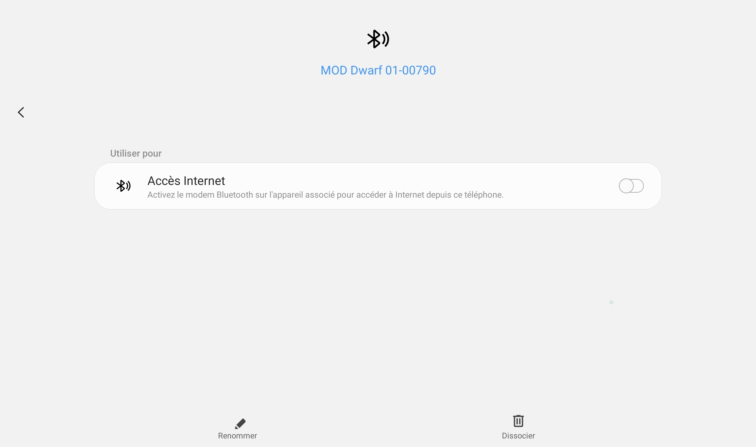

Hi @jon
Finally I bought a Mod Dwarf that will replace my Mod Duox during the return for repair and then the Mod dwarf will take place next to the Mod Duo x on the pedal board. It will run looperlative and mastering effects.
I’ve tried Bluetooth with the mod dwarf and the same Bluetooth dongle and android device and it work perfectly.

Hmm…really weird! Either something is wrong on the MOD DuoX or on the way that it got configured in your tablet. Anyway, we will check it and it’s really nice that we are able to narrow the troubleshooting.
I’m curious about that :slight_smile:
Well just look at those 2 screenshots made with the same bluetooth dongle, the same android tablet but one with the Duo X and the other with the Dwarf.
