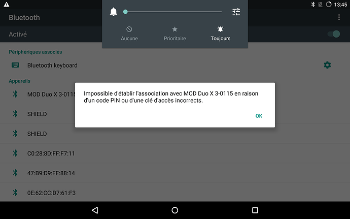

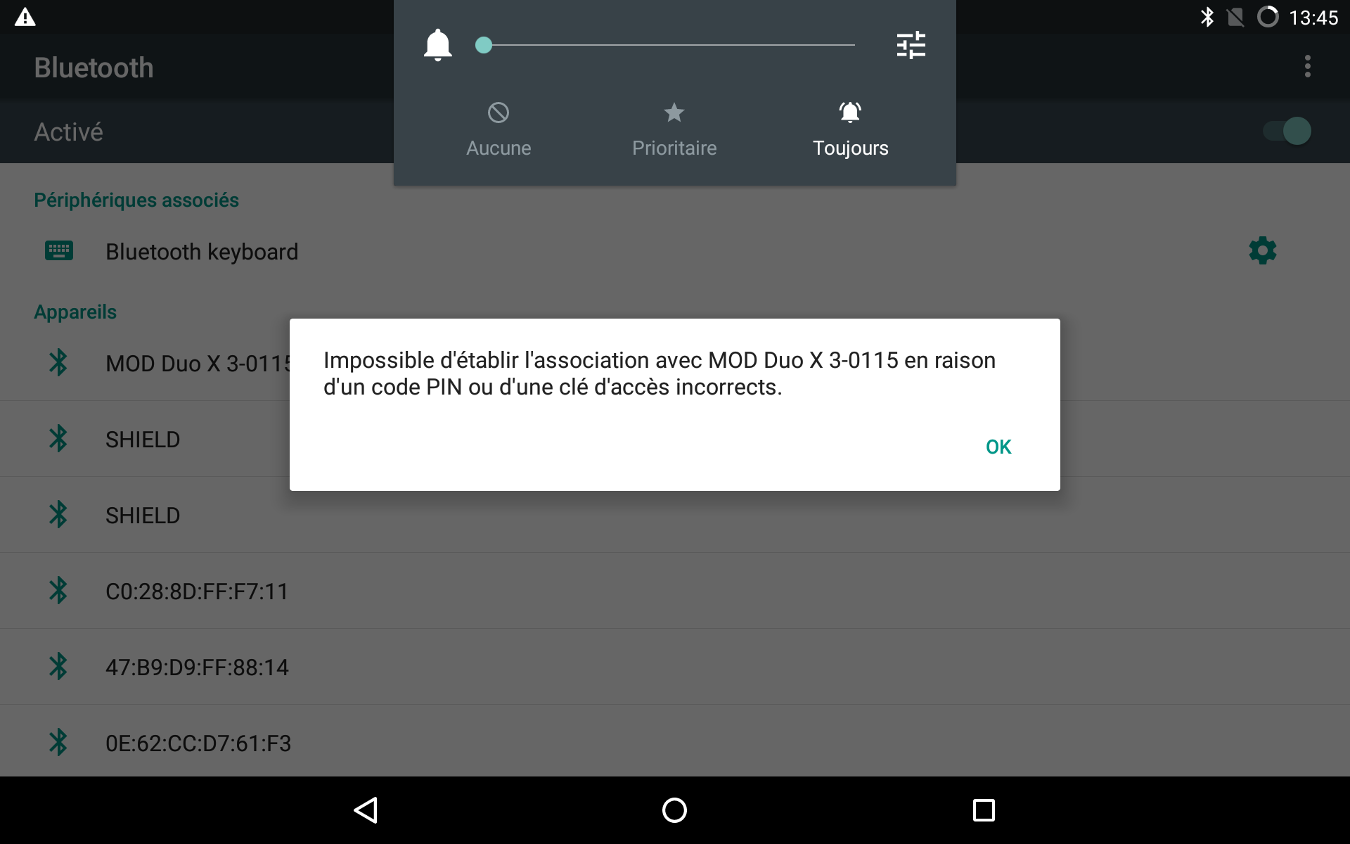

I tried again and then I simply couldn’t connect to Mod Duo X bluetooth

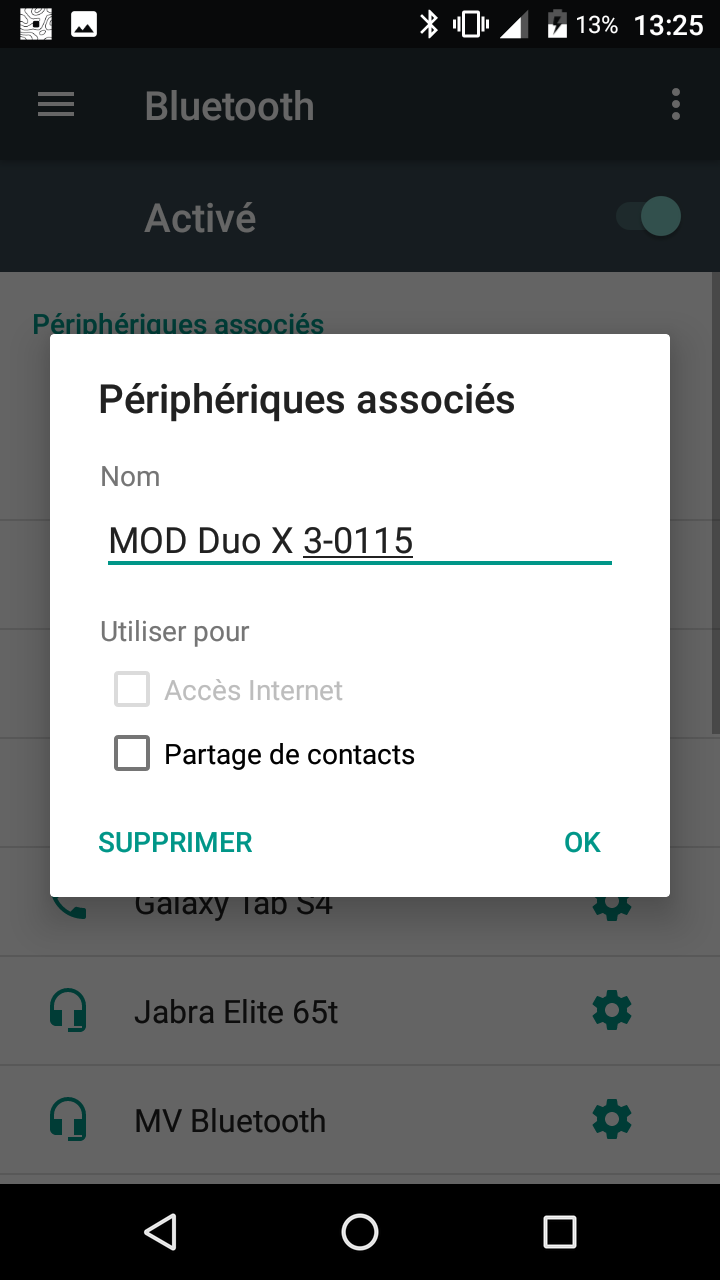

With my phone, a Crosscall action X3 android device, I can connect to Mod Duo X bluetooth but couldn’t check the box to use internet thru this bluetooth connection.

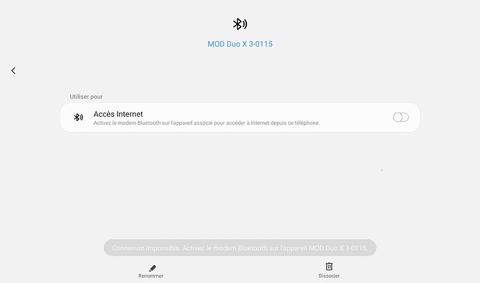

With my samsung S4 tablet I can connect to Mod Duo X bluetooth but the option for this bluetooth connection is empty! No box to check!

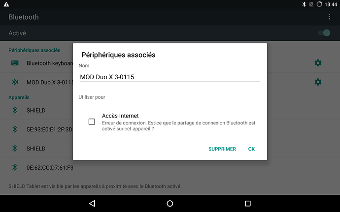

I have something…

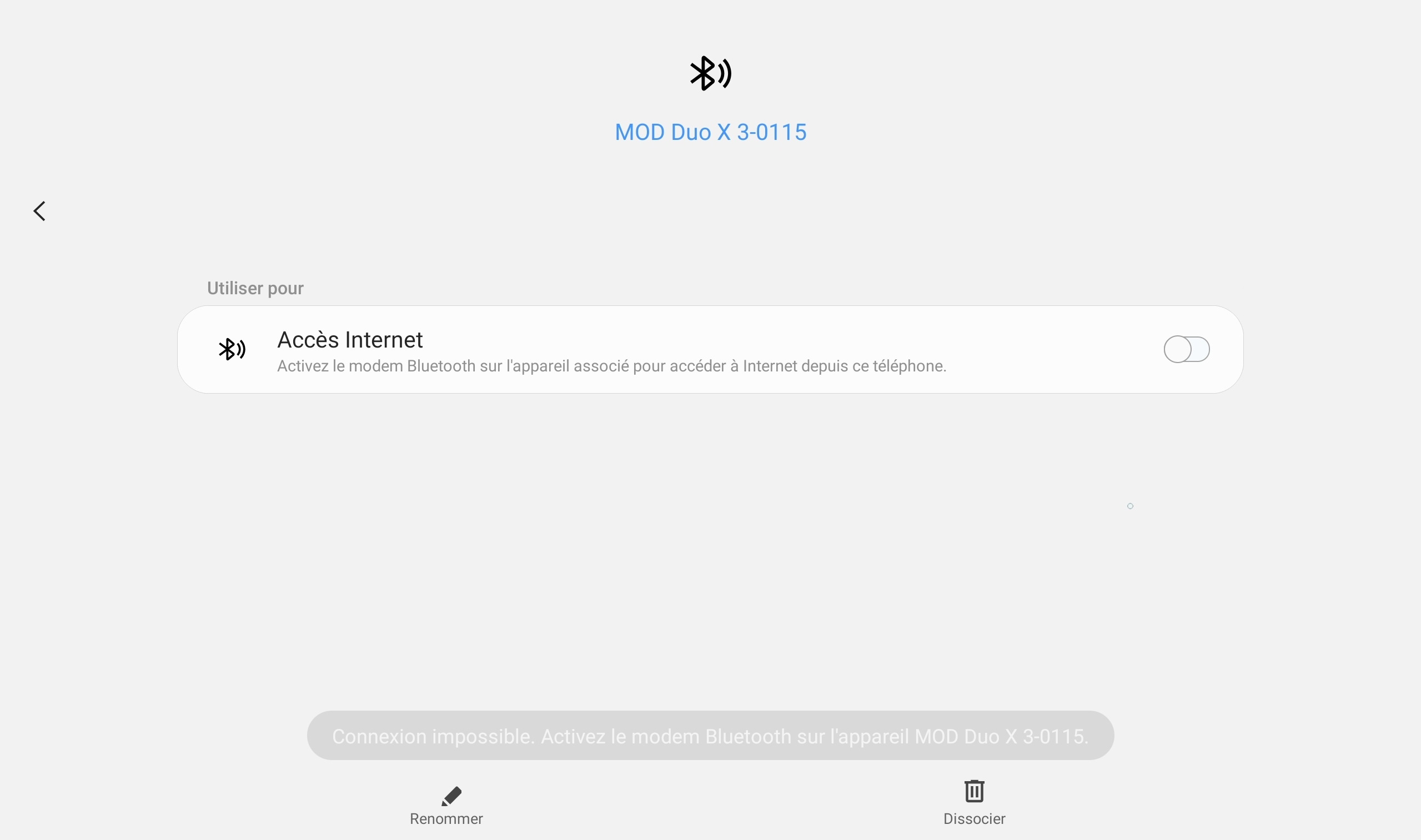

I just tried a third bluetoth dongle that I thought I have never test again, and tried to connect with my samsung S4 tablet.
Now I have the check box option to use internet with bluetooth device on the samsung tablet ! :smiley:
But when I check it it gives me a connection error “connection error, Activate Bluetooth modem on Mod Duo X3-0115”
:pleading_face:

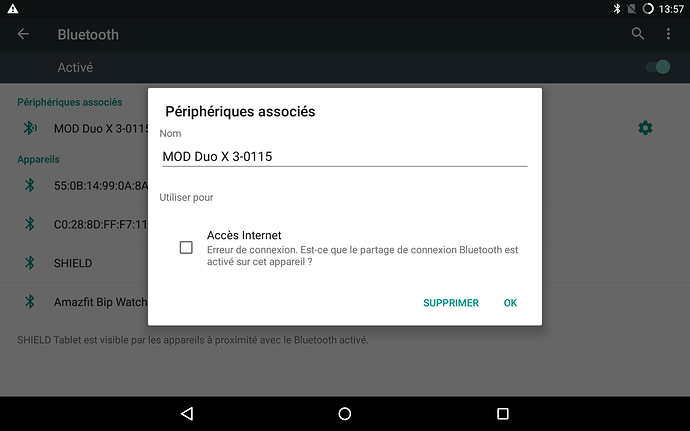

I just tried this bluetooth dongle with my nvidia tablet with android v4 so your old android v6 shouldn’t be a problem. The result is different of what I get with the other bluetooth dongle, but I still can’t connect .
Traduction:
“connection error. Is the bluetooth connection shared on this device?”
It seams normal that your tablet detect an error connecting to internet, because there is no internet on the modDevice, so the tablet can’t ping the google servers (android does that to check the internet connection)
What happen if you cross “Accès internet” box and go to 192.168.50.1 ?
Well, no that’s not normal I couldn’t check this box.
All Android devices refuse me o check this box.
