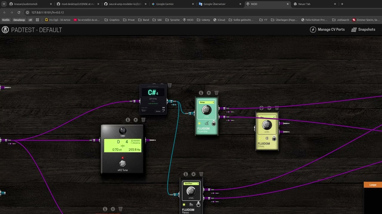

I have an idea: I want to convert an audio signal into MIDI CC so that I can control MIDI instruments—like strings or piano—using my guitar. Here is where I stand so far:
Audio, MIDI, and MOD are all new to me. When I saw the MOD Desktop environment, I wanted to give it a try. I don’t yet know how to compile the code for the MOD device itself; right now, I’m still experimenting with pitch detection, guitar attack sensitivity, and determining exactly when to trigger “note-off” messages.
If anyone has ideas on how to improve this process, or advice on compiling and installing it for the MOD platform, I’d really appreciate the input.

Update:
I took a closer look at the build. Regarding libgig (the SVN and download servers are either gone or broken): it is a hard system dependency, yet I couldn’t find any plugin that actually uses it. That is why I disabled it in my fork, which allowed me to set up the appropriate environment.
Since I wanted to use Docker, I made a few minor adjustments to the Dockerfile to simplify things. Now, the GitHub URL and so on can be controlled via an ENV file.

Okay, I couldn’t resist running a test after all.
I was feeling pretty bold today :wink:
First, I installed the alabs-mod-custom-images custom image, then compiled my plugin and transferred it to the Dwarf. After a lot of debugging, I finally got it working.
