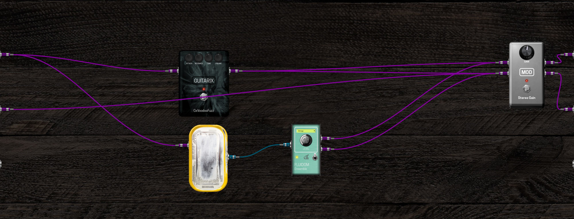

Here is a little board using gxtuner(beta) to have some fun with audio2MIDI:
Strange…I hear the strings in the demo audio for this board, but when I try to use it, I only hear the signal going through the fuzz…
Maybe your input level is to low to make the tuner work. I’ve set my input level on the dwarf to 0dB and the guitar level at full. You may try to put a gain plug before the tuner and increase the level.

FYI I also couldn’t get MIDI on this pedalboard to work at all. I adjusted my input gain and should be set. I’m using the latest Dwarf firmware. Not sure what the issue is…
Hi … I tryed in many way the Audio2MIDI2 setting and I have my dwarf updated , but no sound from the midi Sinth …
maybe @brummer used an internally updated gxtuner build? now that we got the issue in mod-plugin-builder sorted, should we push an updated build to beta?
Ah, yes. I’ve forgotten that I’ve updated gxtuner on my dwarf to the latest git checkout. So yes, may be a good idea to update it in the beta store.
ok so the updated gxtuner is in beta now
