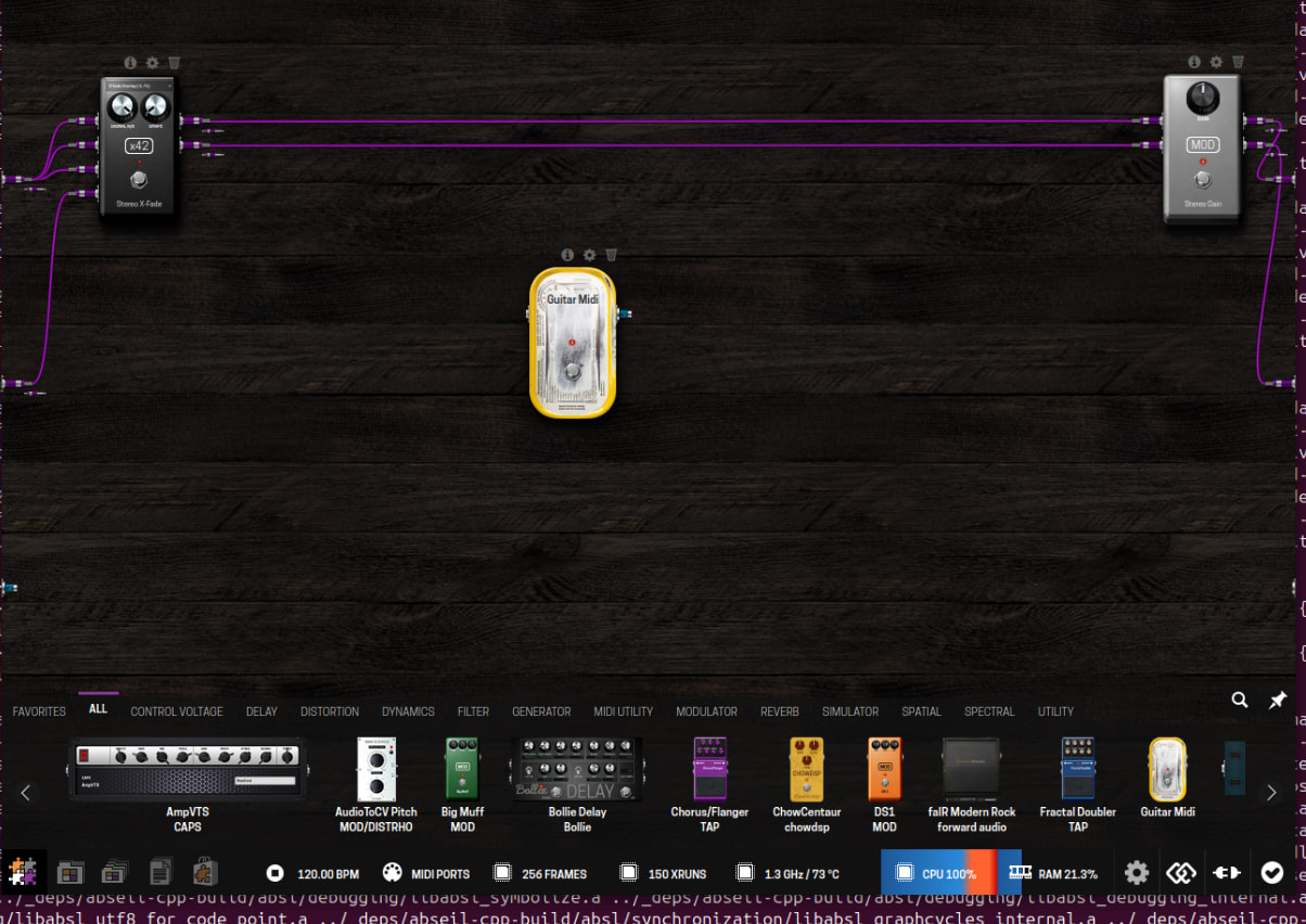

Great! How to use it on Mod platform?
I think GuitarMidi-LV2 currently only works with Linux versions of MOD Desktop.
  1. Download and install guitarmidi-lv2_2.0_ubuntu2404_amd64.deb
  2. Create a directory named lv2 inside ~/Documents/MOD Desktop
  3. Copy installed /usr/lib/lv2/guitarmidi.lv2 to ~/Documents/MOD Desktop/lv2
  4. Restart MOD Desktop
I tested on Debian13, and it works fine.
