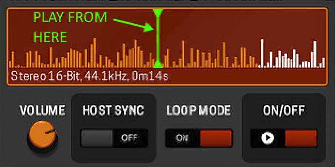

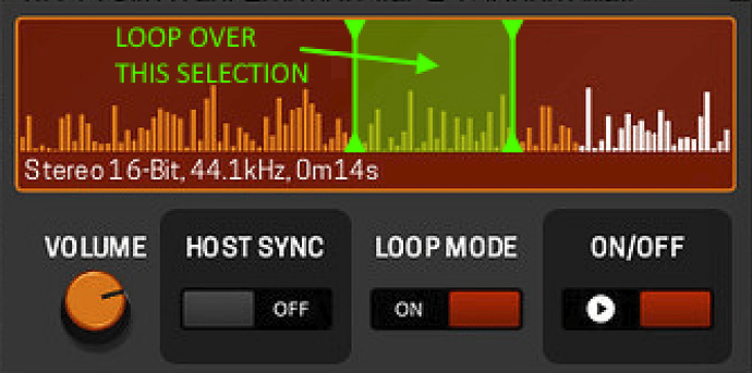

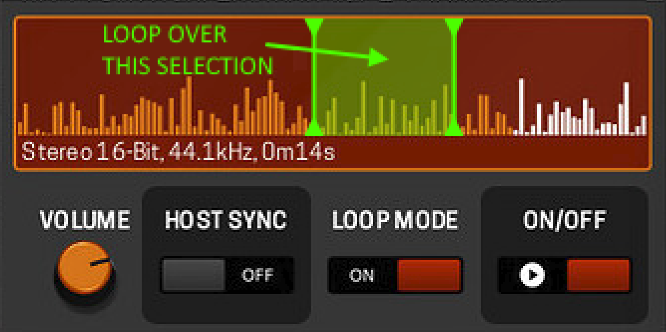

Would it be possible to reposition the cursor? Even better to loop over a selection?
Maybe for a new plugin.
Besides bug-fixing, for this particular plugin I would like to keep features as-is. aka ā€œdo one thing and do it wellā€.
Not that there are no bugs, but for the audiofile plugin my focus will go on bugfixing instead of new stuff.
That said, maybe reusing the engine of this plugin to do a looper?
Not something in my plans for the short term, finishing up DPF and the OneKnob Series comes first.
