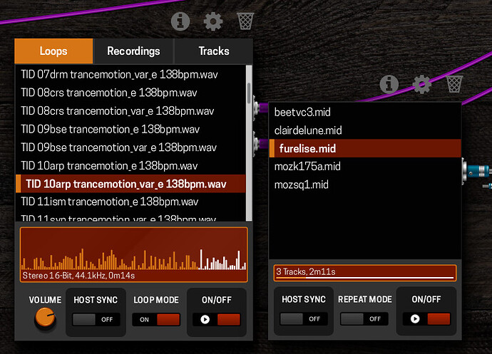

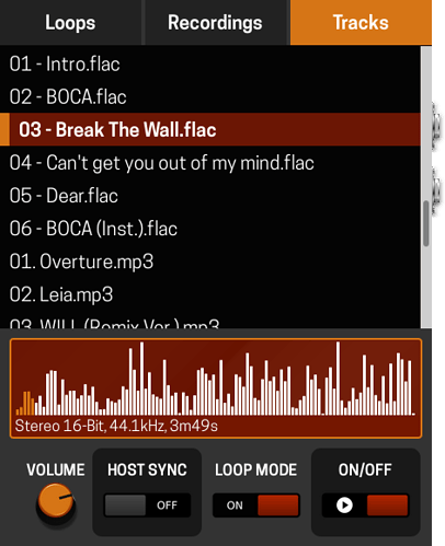

I sorta feel strongly about adding a volume control. Several (if not, all) of the fx and sound generator plugins have a volume control on them. I’m not sure why you wouldn’t add a volume control to this particular plugin. Like, if your thought process is “well, you can always just add a gain or mixer plugin after it,” then that logic would be the same for any of the synth plugins or even fx plugins (“If that fuzz is too loud, stick a plugin after it”). Or is there another reason I’m missing?
So I changed my mind and added a quick volume control.
Plus the host-sync being disabled by default, so it is less confusing to use.
Reworked the way the “playhead” and waveform was done.
I will push this to the store later on, want to do the same treatment to the MIDI file plugin now.
I leave you with a sneak peek :slight_smile:

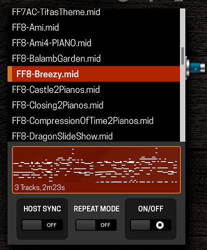

Doing some tests with MIDI files, but have to stop for now.

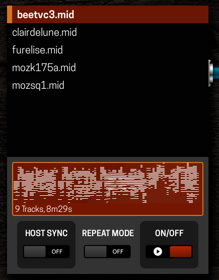

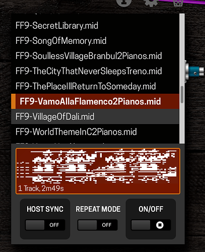

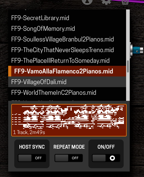

tbh I am not convinced, not sure how useful it actually is..
on a simple midi file, this is the result:
But other MIDI files that are more complex easily become too messy/full that is not suitable on such small area.
EDIT: more regular MIDI files have issues too.
so I am thinking of skipping the preview stuff for MIDI files altogether.
what do you think?
The preview stuff looks pretty neat! I think also the midi previews. Neat, but not really practical though…
In general I’d like to ask how much cpu these previews consume (especially as a DUO user :sweat_smile: ) and therefore, if it is really needed…
It is not stricly needed no, but the cpu consumption is pretty much on the browser side, not the plugin/device side.

I am going with just a progress bar. no need for more fancy stuff for now.
so audiofile and midifile will be like this:
A full MIDI event viewer would be cool for sure, but that seems best in another plugin.
I already had these plugins working before (mostly), the MOD “port” helped to find a few issues and fix them. Then a few small extras that make it a bit nicer.
I am happy with the result.
To be published to the store soon (still as beta, there is at least 2 issues that have been reported here that I want to fix first).
