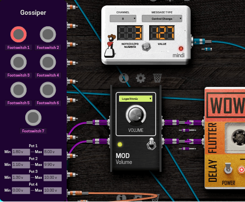

I use a midi controller (Morninstar MC6pro) to engage/disengage multiple plug-ins at once, and use the Dwarf’s switches to engage/disengage individual plug-ins. But to make a plugin be engage/disengage with midi AND a Dwarf’s switch, i use a CV button (here a Gossiper) → trigger the infamous mindi - MOD Audio → send to the virtual loopback… :
midi_trick
If I use the midi controller to activate the WOW delay send shown here and other plugins, the Dwarf’s switch would change it’s state to ON.

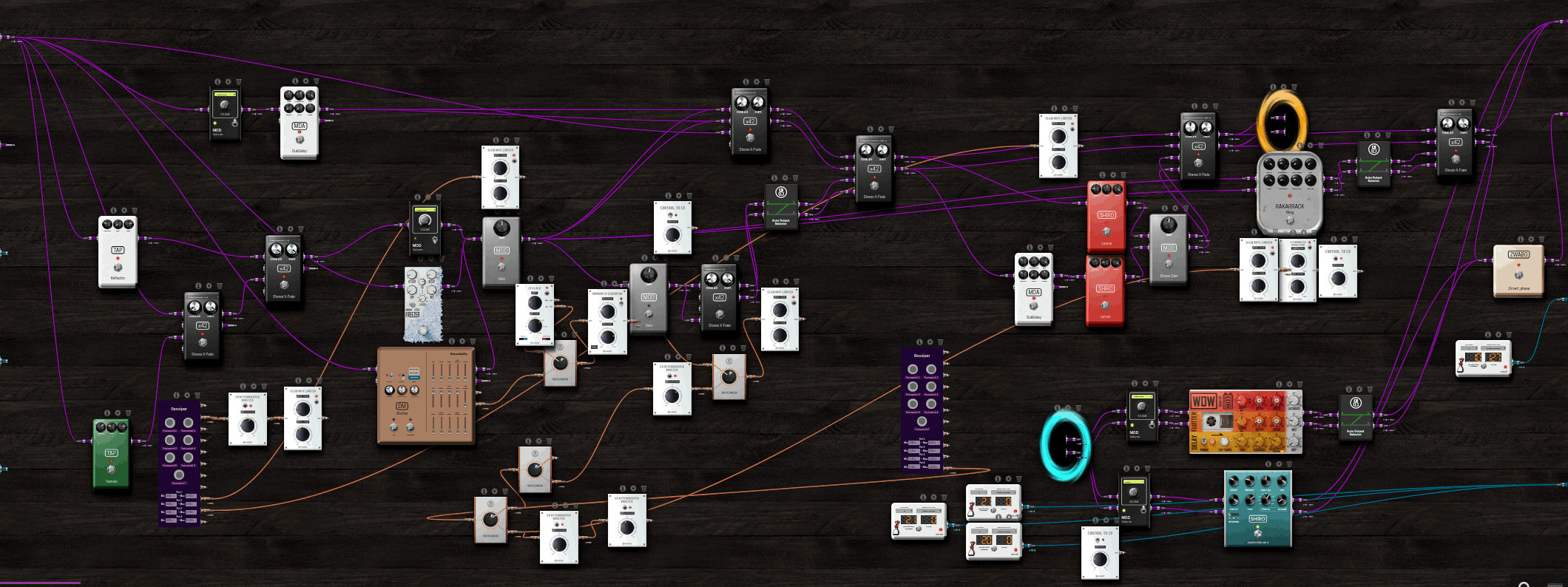

If it could be possible to simply modify a parameter with the device AND midi :
  • it would be synced between my controller and the Dwarf
  • it could simplify a lot my pedalboard and a few CPU usage (about 83% → 72%) :
midi_trick_pedalboard
