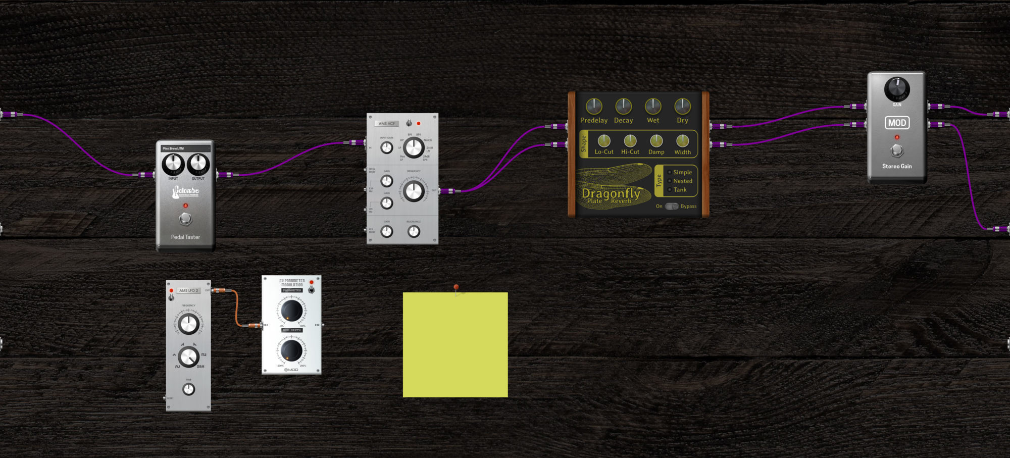

Thanks, but where should I plug it in? This is how Stepper looks like in pure data.

Here is an exemple :slight_smile:
  • Click on Manage CV Ports
  • Replace the AMS LFO 2 + the CV PARAMETER MODULATION by the 8 Orange stepper .
  • Assign the CV output to AMS freq
  • Adjust the 8 Orange faders
