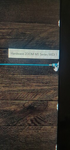

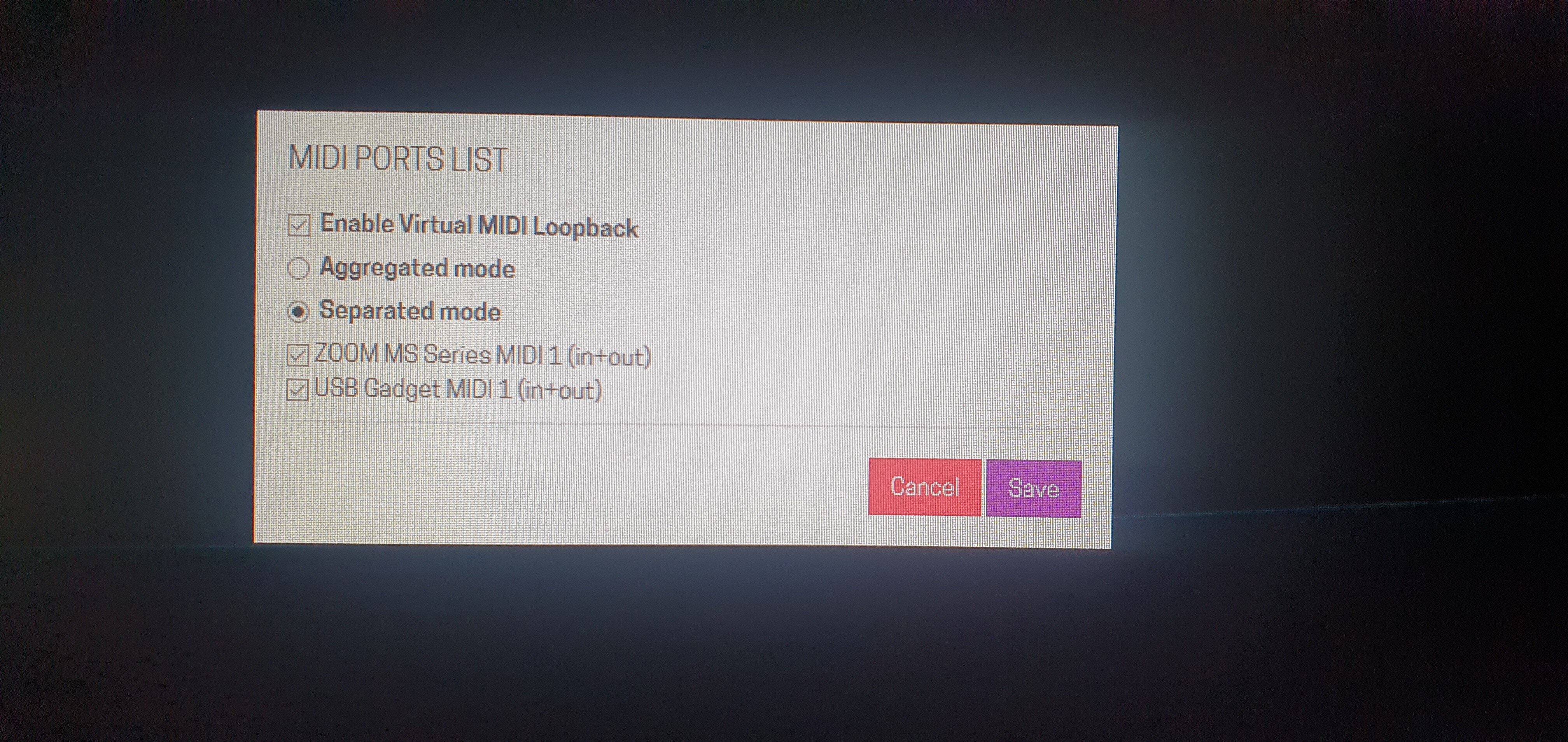

Ok its dumb ass Thursday. Had another go this morning and actually found I had a new check box in MIDI setting to enable the Zoom. And it gets a separate MIDI out too!

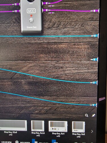

OK tested with a second CDR70 , shows up as a second output but unfortunately when you select one USB out the other gets a plug in the socket too preventing any further use.

Did you try the “Aggregated” mode for midi input?
Sorry Simon, should have been more specific. I was looking to control the zooms separately. Connecting them agregately works perfectly but both receive the same message and not what I was looking for.
