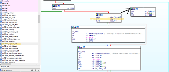

I’ve used IDA disassembler to drill down the binary compiled driver internals ( /usr/lib/modules/4.4.167-rt176-duox/kernel/drivers/net/wireless/mediatek/mt7601u/mt7601u.ko) that I’ve found on the device to find the solution.
As you can see below, there is a CMP assembler instruction, that is responsible for deciding to allow EEPROM version:
Responsible instruction is CMP W2, #0xC At this place driver makes a comparison and decides not to work with my dongle, as soon as my dongle has version 0xD and the maximum allowed is 0xC.
Swapping this to CMP W2, #0xD will force the driver to allow my EEPROM version.
I’ve made this by replacing the following corresponding sequence of bytes: 5F 30 00 71 to 5F 34 00 71 with a hex editor at address 0x0000400C, and replaced the original mt7601u.ko on the MOD device after remount rw.
After such change and device reboot I’ve got MOD Duo X sucesfully connecting to my WiFi network:
